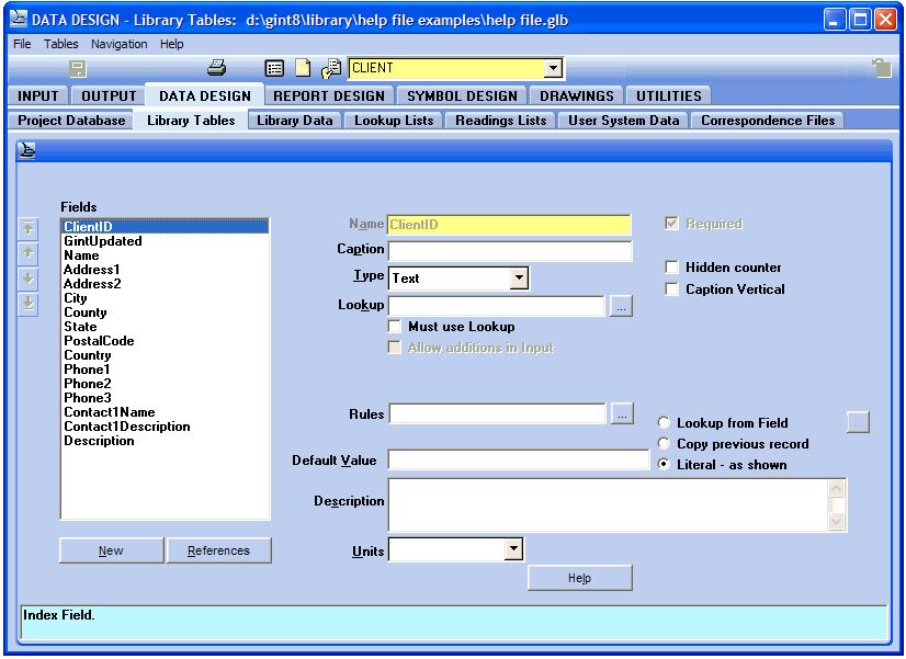

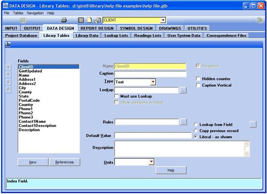

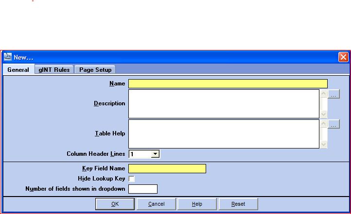

  1. Move to Data Design►Library Tables
  2. Select the File►New menu item
  3. Every library table must have a key field. This is the record identifier. The default value is "Key" but you will generally want to replace that with a more appropriate word. Type CLIENT for the Name, ClientID for the Key Field Name, and click the OK  button

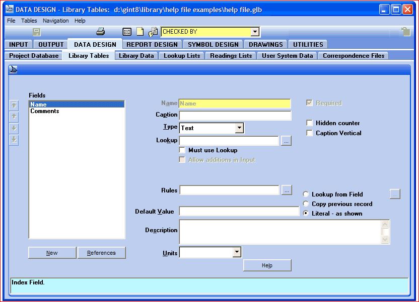

  4. Using the New button, you will add the desired fields. Just type in the Name property. Leave the other properties as the defaults.

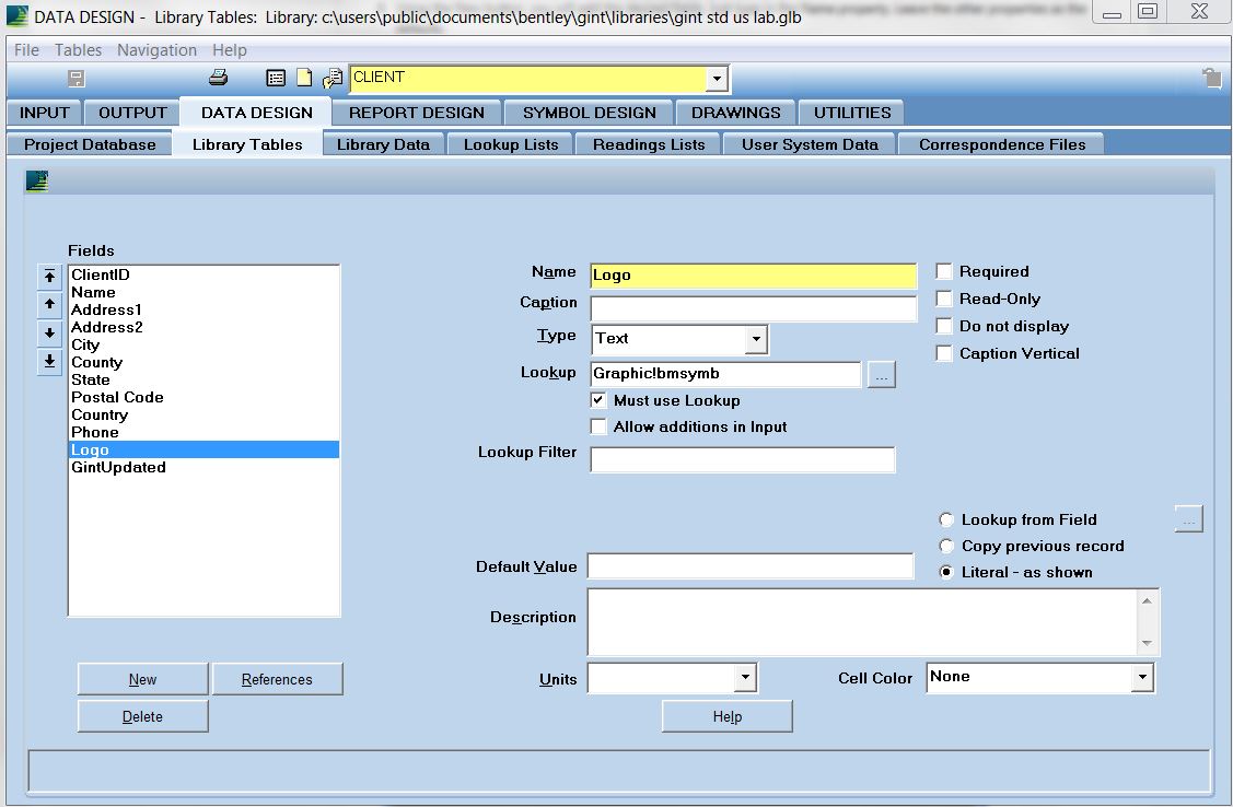

5. To use a logo field you will need to add a lookup to bitmap symbols ► hit the lookup button and choose Graphic!bmsymb ► check Must use lookup

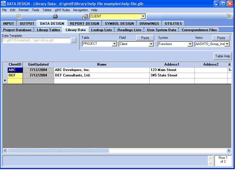

6. Now move to Data Design►Library Data (the tab to the right of Library Tables) and add some client data

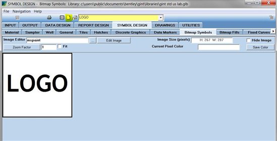

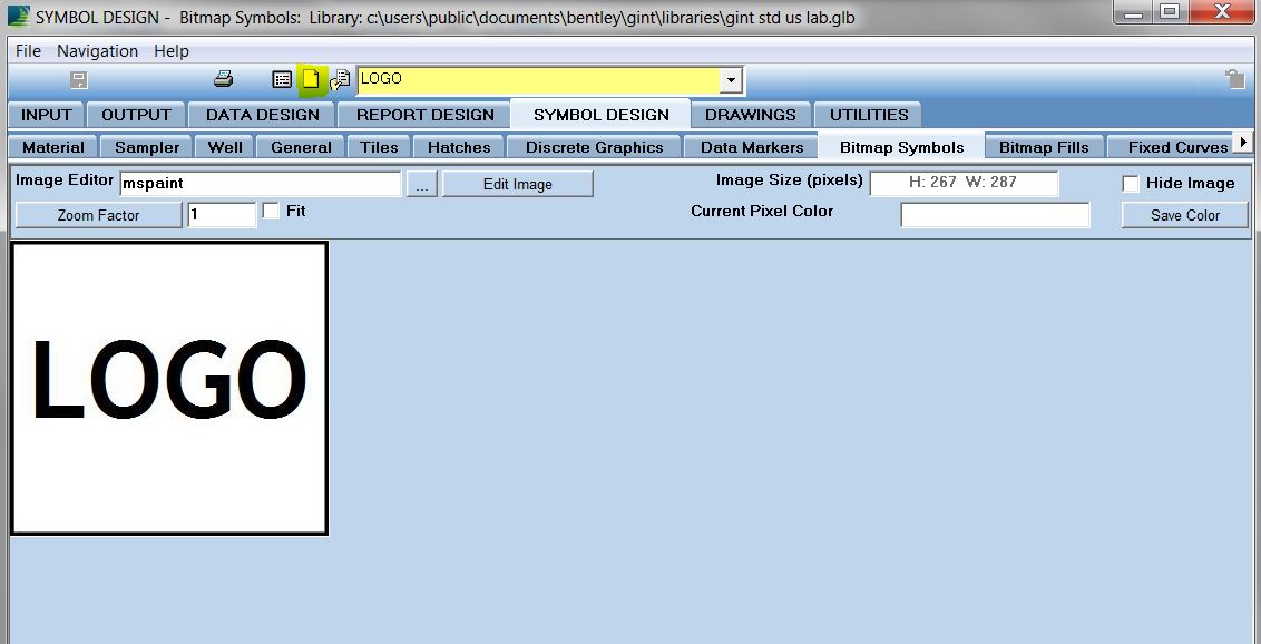

7. You will need to add any additional Client logos in Symbol Design►Bitmap Symbols. Hit the new button and load raster file
8. You would then associate this lookup to a "ClientID" field in your PROJECT table in Data Design►Project Database as described above under the Implement section. At input time, you will see this list when you are on the ClientID field. The list for a library table lookup will always consist of the key field and the first field to the right of the key field (ClientID and Name in this case). When you select a record, the key field will be pasted into your project database field.

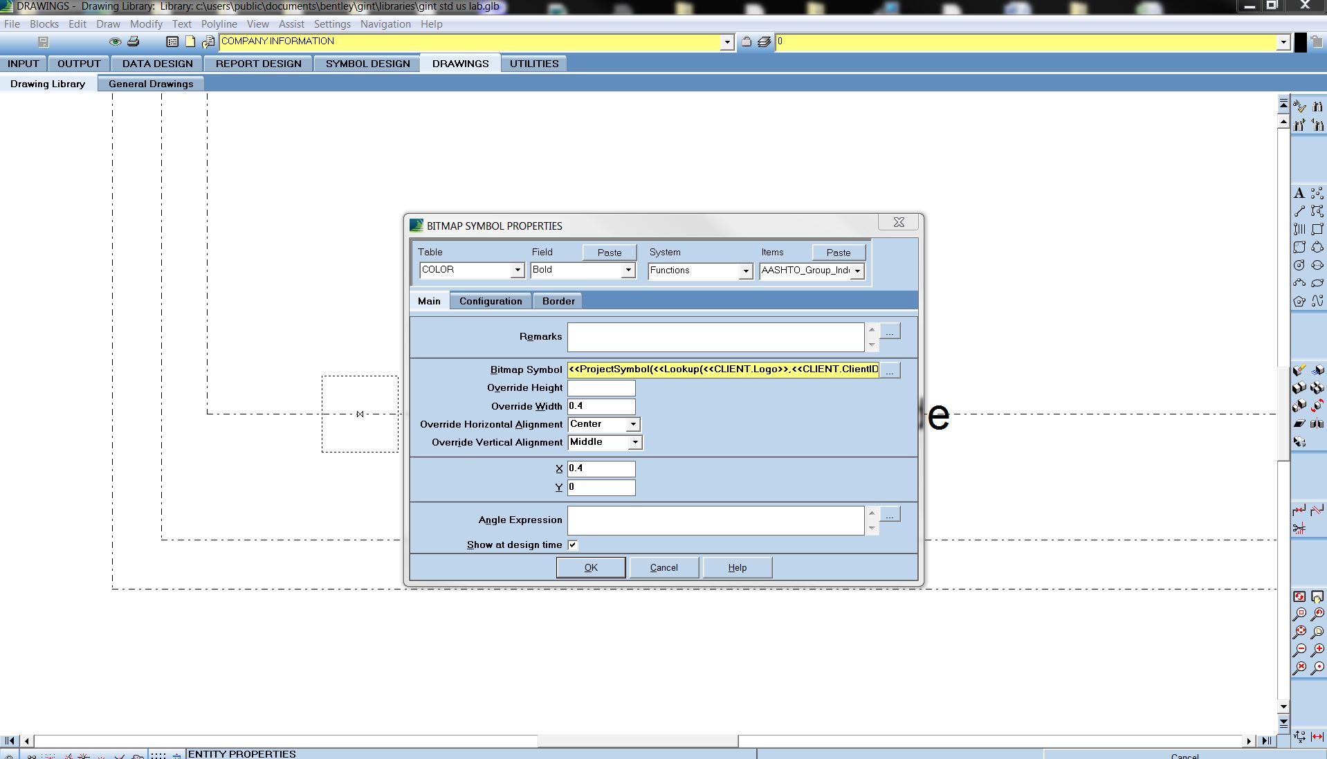

9. Lastly you will need to change the bitmap symbol entity in your report. Many times this bitmap entity is stored in a    Drawing block called company information. It can be found in DRAWINGS ►Company Information. Double Click on the Bitmap entity and change the bitmap Symbol property to
<<ProjectSymbol(<<Lookup(<<CLIENT.Logo>>,<<CLIENT.ClientID>>=<<PROJECT.Client>>)>>)>>
