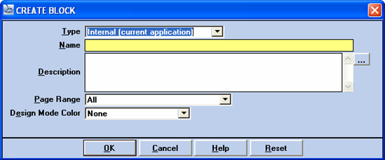

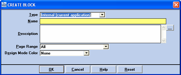

  3. Select Blocks->Create Block. You see the Create Block dialog box:
  4. Enter the following values:
    Field NameValueComments
    TypeInternal (current application)Creates a reusuable block that can be inserted into any log.
    NameLOG COLUMNS
    Page RangeAllSpecifies which pages of output the block appears on, for example, only on page 1, or all pages after page 1.
    Design Mode ColorVery Light BlueSpecifies the color of the block contents (and corresponding block insert) when the block appears in a log report design.
  5. Click OK. The CREATE BLOCK: Select Entities: prompt appears in the command box.

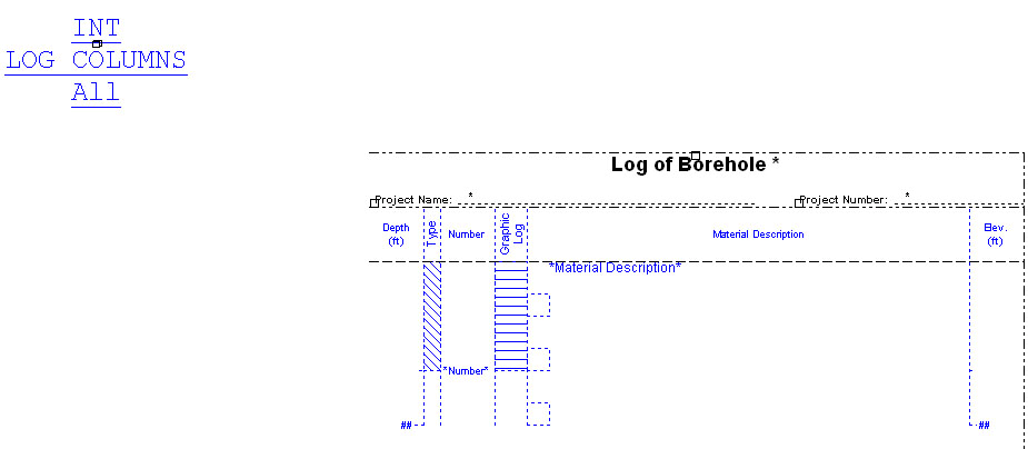

  8. Click the Zoom Extents   button to show the entire report design. You should see a block insert for the new block.
  9. Click the Zoom Window   button, then click once at each corner of a viewing rectangle that only includes the block insert and the selected and unselected report entities. It should look like this:
  10. Notice the block insert, which reads ‘INT -- LOG COLUMNS -- All’. This identifies the block that has been inserted, including the block type (INT means Internal), the name (LOG COLUMNS) and the page range (All). Also notice that the block insert’s color matches the color of the entities in it.
    Unique block colors are very useful, especially when you have several blocks in the same report. Always specify a Design Mode Color when creating or inserting a block, and do not use ‘None’, ‘Black’, or the color of an existing block in the report.
