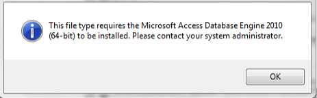

When trying to connect a gINT project database that uses an Access Database File, an error message stating a connection problem appears at the bottom of the gINT Connectivity dialogue
or
This file type requires the Microsoft Access Database Engine 2010 (64bit) to be installed.  Please contact your system administrator.

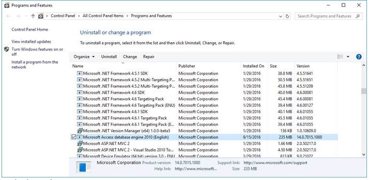

1:  Uninstall the Microsoft Access Database engine 2010

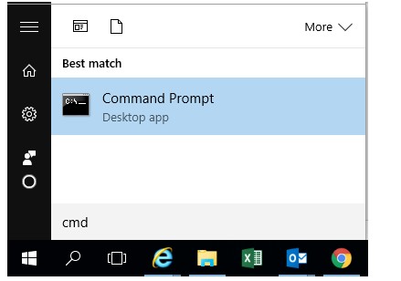

2. Open the Windows Command Prompt by typing "cmd" in the search box under the Windows Start menu.

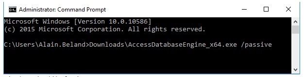

3. Run the installation of the Microsoft Access database engine using the passive mode:
4. When the installation is complete, restart the computer and the connection to the database should be fixed.
