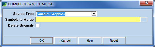

You can copy composite symbols between the Material, Sampler, Well and General applications using the File   Merge option. For example, if there is a Sampler symbol that you wish to copy to the Material application, click the Material tab and select File   Merge. You see the COMPOSITE SYMBOL MERGE dialog box.
You specify the source application in the Source Type list (you’d choose ‘Sampler Graphics’ in the example), and then select the desired symbol or symbols using the Symbol(s) to Merge field. To avoid breaking any references to the source symbols from reports and elsewhere, you are advised to leave Delete Original(s) unchecked. You can rename any copied symbols in the destination application without harm.
