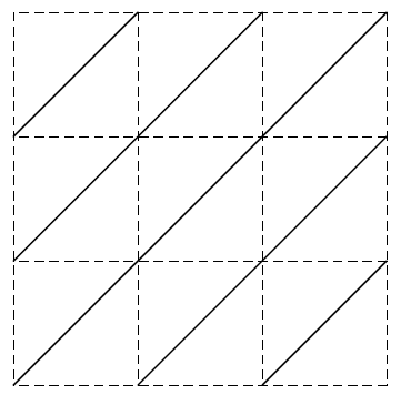

  5. To see what ‘LINE45D01’ consists of, go to SYMBOL DESIGN   Tiles, then select ‘LINE45D01’ in the object selector. The tile’s drawing consists of a single diagonal line from the lower left corner to upper right.
  6. Click the Properties  icon, then click the Tile Structure tab. Notice that the cell is .05" square, which is considerably smaller (1/8th the height) of the ‘GRAV01’ tile we viewed in Part 3. The Mapping is ‘Repeat’, which creates a tile pattern like the following:

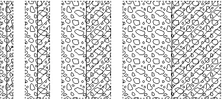

  9. Let’s make the diagonal lines more widely spread apart. To do this, specify a Scale value of ‘2’ in the second row of the grid. This enlarges the tile to twice its actual size in both the horizontal and vertical.
  10. Click the Preview   button to see the result at the bottom of the window. (The display is not automatically refreshed—you have to click Preview.)
     Note: The View Multiplier field above the grid allows you to preview the final symbol at different scales. When unspecified, the preview is at 100% (that is, ‘1’ or blank). If you were to enter ‘2’ and preview, you would zoom in. If you were to enter ‘.5’, you’d zoom out.

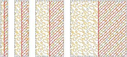

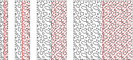

  11. Change the Override Color in the second row to ‘Very Light Red’, then preview. The diagonal lines and vertical border in the right half of the symbol change to red.
  12. Change the Override Color in the first row to ‘Very Light Orange’, then preview.
    Notice that the gravel tile extends all the way across the material symbol, so it affects both the left and right halves.
    Notice also that the closed polyline shapes that make up the gravel tile are not colored in. This is because the shapes are hollow in the underlying tile. We need a gravel tile with filled shapes if we want them to be a solid color.

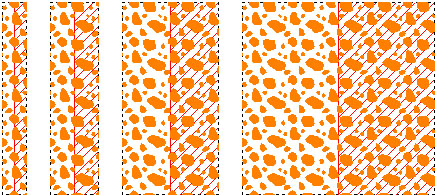

  17. Enter values for the replacement gravel tile in the empty bottom row. Click in the Fill Type[!Symbol] cell in this row, then click the Browse   button that appears in the cell. Specify a Type of ‘TILE’ and a Symbol of ‘GRAV02’.
  18. In the same row, specify a From % of ‘0’, a To % of ‘100’, and an Override Color of ‘Very Light Orange’. Preview the symbol. Notice now that the gravel pieces are solid orange.

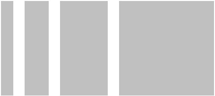

  19. You can also create a solid background in the composite symbol. To do this you add a new row that specifies a solid instead of a tile. In the blank empty row at the bottom of the grid, enter ‘SOLID’ in the Fill Type[!Symbol] cell (a Type of ‘SOLID’, and nothing entered for Symbol), and an Override Color of ‘Very Light Gray’.
  20. Preview the symbol. Oops! We’ve turned everything solid gray.
    The problem here is that the order of rows in the data entry grid specifies the layer order (also sometimes called print order) of the component fills, in other words, what prints on top of what. The order of rows, from start to end, specifies the order of layers from bottom to top—first row on the bottom, second row on top of that, and so on. To put the gray solid at the bottom, it needs to be the first row, not the last. And to put the diagonal lines on top, that tile needs to be the last row.
    To reorder rows, you position the mouse pointer in the blue square to the left of the row you want to move, press and hold down the right mouse button, and drag the row up or down.
  21. Right-mouse drag the ‘SOLID’ row so that it is first in the grid. Then right-mouse drag the ‘LINE45D01’ row so that it is last in the grid. Preview the symbol. Now we have the desired effect.
