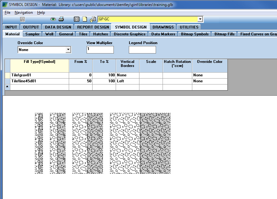

Ensure that training.glb is the current library and training.gpj is the current project.- Go to SYMBOL DESIGN Material. Select ‘GP-GC’ in the object selector.
- Select File
Copy Page and specify a Page Names to Copy To value of ‘ANOTHER TEST MATL SYMBOL’. - Go to SYMBOL DESIGN

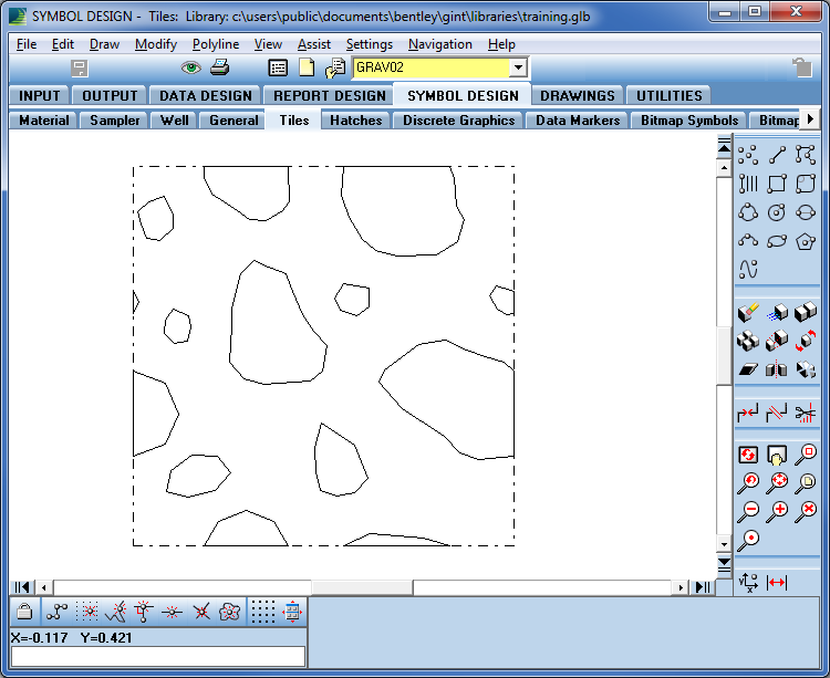

Tiles. Select ‘GRAV02’ in the object selector.
- Select File

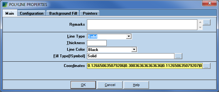

Copy Page and specify a Page Names to Copy To value of ‘A TEST TILE’. Click OK, If asked, answer ‘Yes’ to overwrite the existing tile of this name. - Double-click on the edge of one of the larger drawing objects (gravel grains), such as the one 1/3 of the way from the top and 1/3 of the way from the left. The POLYLINE PROPERTIES dialog box appears.
- In the Main tab, specify a Thickness of ‘0.02’ and a Line Color of ‘Medium Magenta’.
- Click the Configuration tab, and specify an Override Fill Color of ‘Medium Cyan’. Click OK, then preview
the tile.
Notice that the gravel grain you altered now has a thick magenta border and a cyan fill wherever it appears. Close the preview.

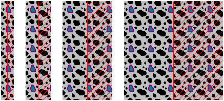

Material. - In row 2, replace the Fill Type[!Symbol] with a Type of ‘TILE’ and a Symbol of ‘A TEST TILE’.
- In the same row, delete the value from the Override Color field. Preview the symbol.
Notice that the gravel layer contains black grain symbols except for the one that we filled in cyan and outlined in magenta. In other words, the gravel tile is being used exactly as it was created.

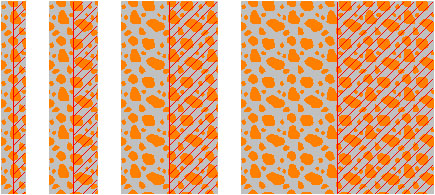

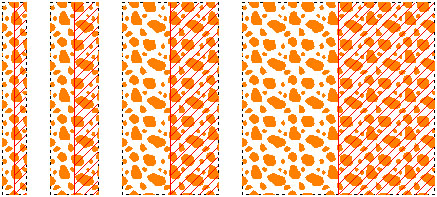

- Close the preview. In the second row, specify an Override Color of ‘Very Light Orange’. Preview the symbol.
Notice that now everything on the gravel layer is orange, including all grain symbols and their edges.

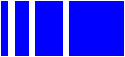

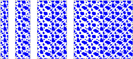

- Close the preview. Specify an Override Color for the entire symbol, at the upper left of the window, of ‘Very Light Blue’. Preview the symbol.
Not a very useful symbol, is it? What has happened is we overrode the color settings on all layers, including the solid gray background layer, making everything blue.
- Close the preview. Highlight and delete the top row (using the Delete key), then preview again.
Now that there is no longer a solid blue layer, the gravel and diagonal lines layers can be seen. All objects on these layers become blue.
- Close the preview. Change the master Override Color for the composite symbol to ‘None’. This restores the colors of the two remaining layers. Notice that the gravel grains are still solid orange, because we are still overriding the color of the gravel row.
