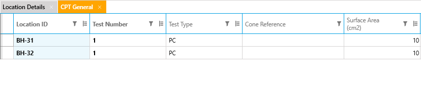

In the CPT General (Static Cone Penetration General) table there will be data relating to each push of the CPT unit. This includes test type (or cone type), surface area, rate of penetration and cone reference. There are two Key Fields which are required which are the location ID and the Test number.

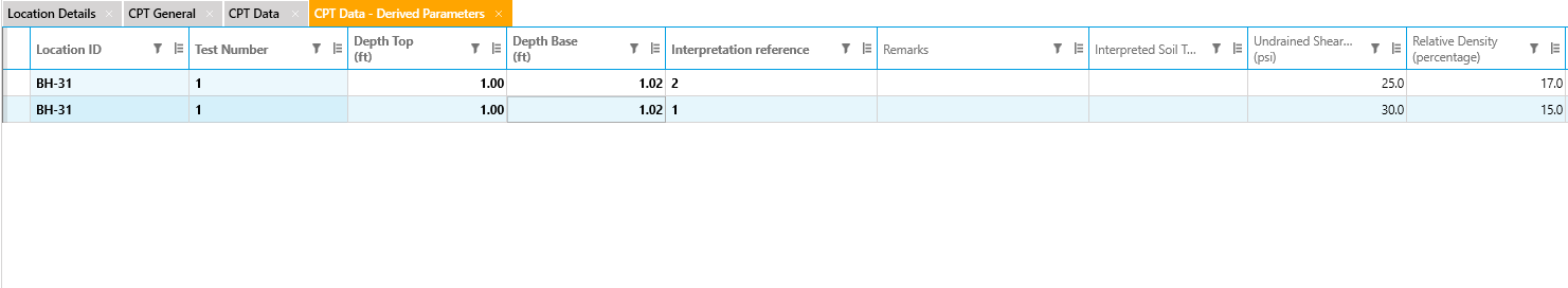

The derived parameters in the CPT Data – Derived Parameter (Static Cone Penetration Derived Parameters) table stores the parameters like undrained shear strength and relative density.
The Key fields are the location ID test number from the general table as well a depth top and depth base for the range that the derived parameters cover. There is an interpretation reference to allowed more than one interpretation of the derived parameters over the same depth range.
