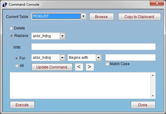

2. Go to 'System | Command Console'.
3. Set the 'Current Table' to "PICKLIST":
4. Click the button to 'Copy to Clipboard'.

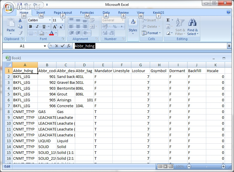

5. Open Excel and 'Paste' into a new spreadsheet. The entire contents of the PICKLIST table will appear:
6. Only rows marked as "GEOL_GEOL" under the column headed 'Abbr_hdng' are required - delete the other rows from the spreadsheet:

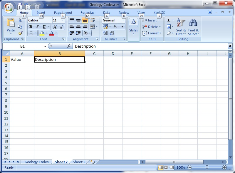

7. A clean up routine is required to remove any trailing white space from the values. To do this go to a new sheet within the workbook and add two column headers with the names "Value" and "Description" respectively:

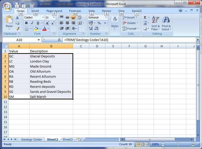

8. Use the Excel TRIM function in the first of the cells in the newly headed 'Value' column to reference the first of the cells in the 'Abbr_code' column. Then apply the TRIM function to each of the cells under the 'Value' and 'Desciption' columns. Hint: only apply the function to the rows which contain data to avoid blank picklist entries being created.

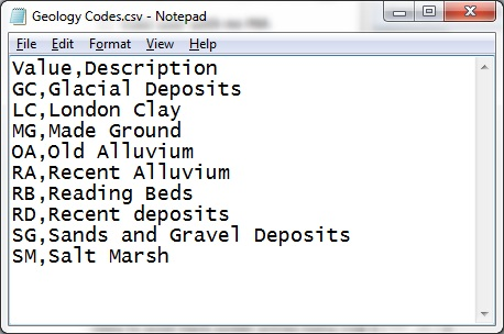

12. Save the file in a location where it can be easily found later. Consider opening the file in 'Notepad' to confirm the results - it should appear similar to the example below:

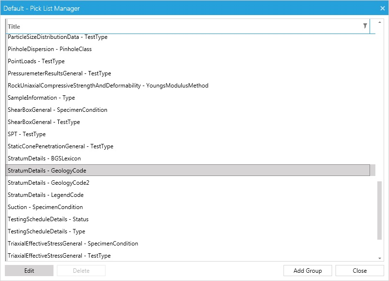

16. Click the 'Picklists' button.

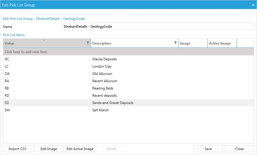

17. In the interface which opens select 'Stratum Details - Geology Code' and click the 'Edit' button:
18. Click the button to 'Import CSV'. Browse to the .csv file you created earlier.
19. The list of available Geology Codes will now update:
20. Click 'Save' to commit the changes.
