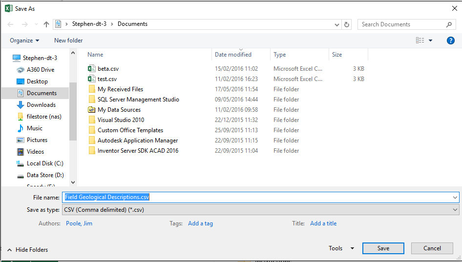

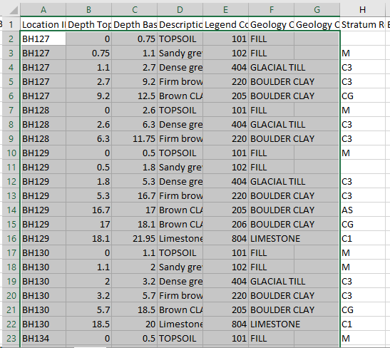

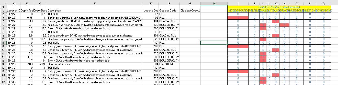

Explanation
When reviewing your Geology data, it may be useful to create custom geology code 2 values based on the descriptions found within the data. This is most common where the main constituents are capitalised within the description. It is not currently possible to do a filter within HoleBASE SI that is case sensitive (it will treat gravel and GRAVEL as the same) which would allow for a quick interrogation of this data, however, it is possible to export the data and then edit using Excel, then import it back in.
Process
Download
The tool mentioned in the above process can be downloaded from 71434295474e8e14e3378d53636d43b9.iix.
