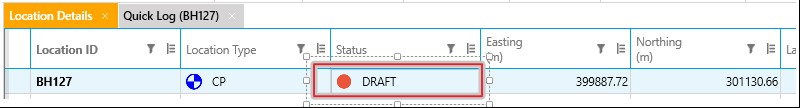

1. Set the Status of the location to "Draft" in the location details grid:

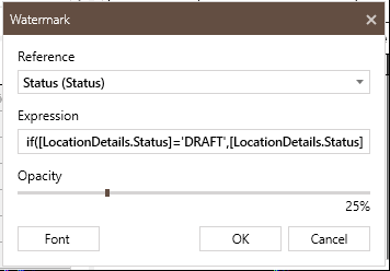

2. Open the template you use in Template Studio
3. Go to Design>Watermark
4. Set the Reference Picklist to "Status(Status)
5. Add this expression to the Expression box: if([LocationDetails.Status]='DRAFT',[LocationDetails.Status],'')
6. Set the Opacity to be as you wish and select "ok" to the changes.
7. Save the template and preview in HBSI.
