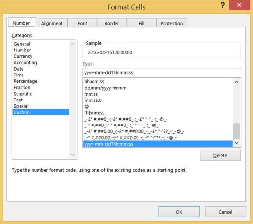

When using the Data Entry Feedback Tool you try to export .CSV but get an error saying "excel run time error 13 type mismatch". This is generally due to a date format being used which can prove to be ambiguous when processed by a computer.
Resolution
Users of the British Standard Configuration Pack can generally edit the format of the date cells so they are then in a dd/mm/yyyy or derived format. Users of other formats, such as ASTM in the US, will need to create a custom date/time format as illustrated below:
For convenience the format can be copied and pasted from here:
yyyy-mm-ddThh:mm:ss
With this format in place the data can be exported without error in the required data format ready for import into HoleBASE SI.
