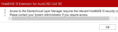

Issue Summary
When trying to access the Layer Manager there will be a warning message preventing access if the user logged in is not an Administrator. The message will confirm you require the relevant security role and to contact your System Administrator if you require access.

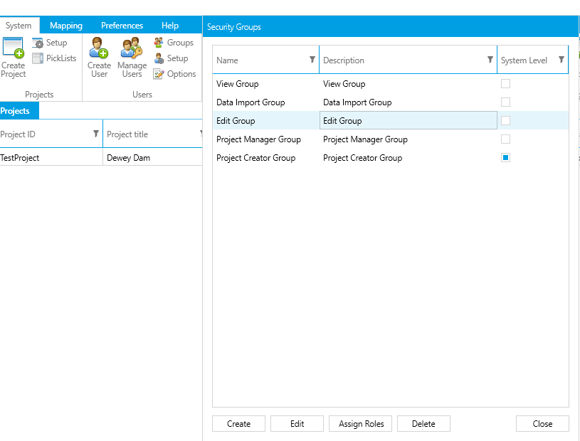

To get access to the Layer Manager the user providing access must first log into their HBSI account, navigate to System then groups.

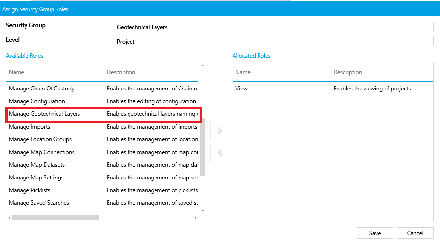

From here the group the user is associated with needs to be selected followed by pressing Assign Roles.
The role "Manage Geotechnical Layers" needs to be selected and brought across to the allocated roles section by pressing the relevant arrow key.
Once the role is assigned and saved the user will have the rights to access the Layer Manager.
