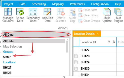

From the "All Data" selection tool select one of the Location Groups Previously created.
This will update the data explorer on the left to only contain data for that group.

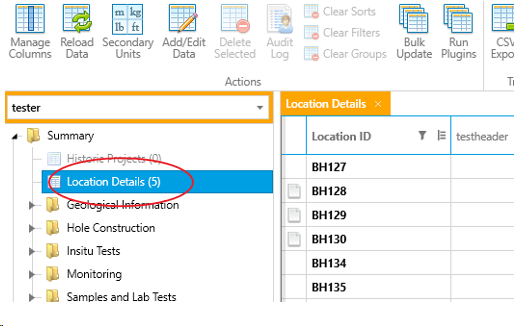

For example, my project as a total of 28 locations and my "Tester" Location Group contains 5. Below we can see that
The location details is now only showing the 5 locations listed:
Double click the Location Details to then open the Grid that contains just so locations.
You can now locate the "Location Group Name" column , select "Bulk Update" from the ribbon
Select the Column "Location Details Name"
Add the value which will be the name of your location group.
Then select "Save", this will add the location group name to all the locations in that group.
