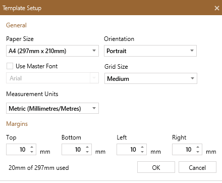

Explanation
A combined log is created from existing templates you currently have. So the first thing to do is make sure the logs you wish to combine are setup in template studio.
Process
Once you are happy with those templates;
Note that if you wish to edit the combined log, you actaully edit the templates you used to make the combined log. You cant edit the combined log directly.
