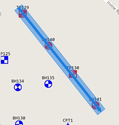

Open the mapping and draw the section line as appropiate.
Change the title of the new section to the required value.
Draw the section using the Quick Section button. The section will then draw and the title will reflect the name of the section as required;
