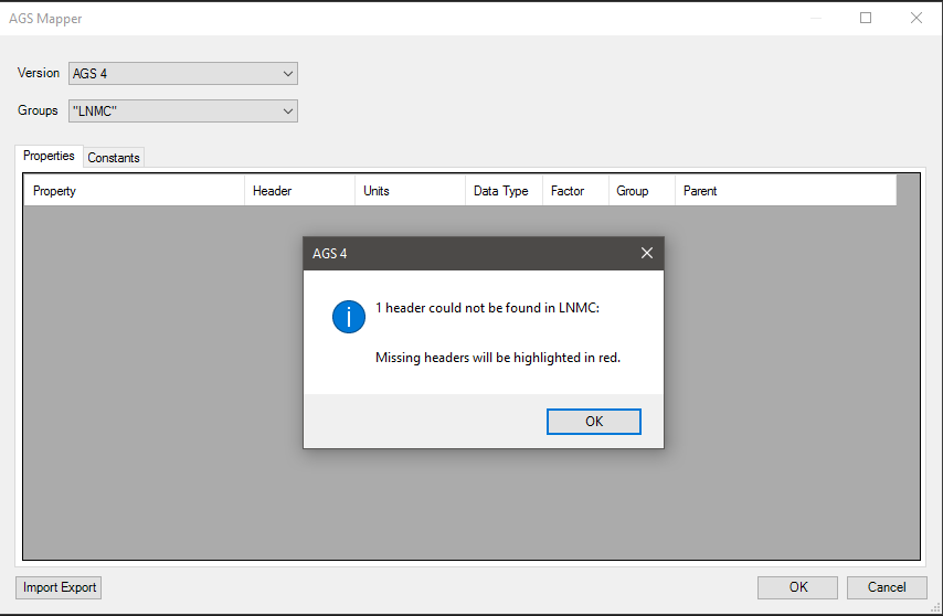

When you import an AGS mapping file and you check it, you can get this error message.
This means there is something wrong with your AGS mapping file.

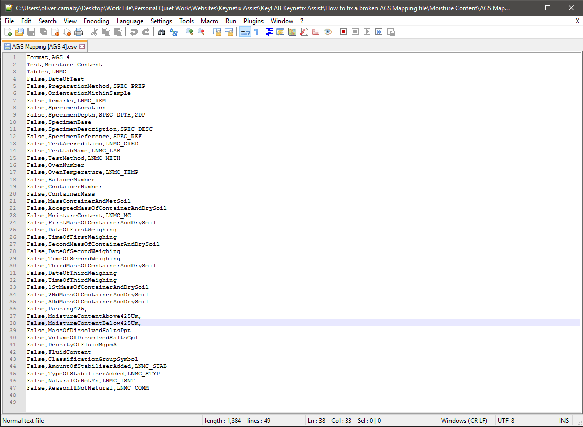

Process
To fix this problem and get the mapping file working correctly. You will need to get a complete export of the affected test. Extract the files and open (with note pad) the .csv file for the version of AGS which is affected.
In the example above there are some commas at the end of the lines 36, 37 and 38. These commas are what cause the mapping to not import correctly. To fix the problem remove the commas and reimport the file.
