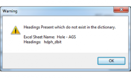

When KeyAGS reads an Excel template it looks for column headers which are defined within the AGS dictionary. These headers reflect the AGS version which has been specified by the version toggle button:
However, there are occasions where field headers are defined in the spreadsheet which are not defined within the AGS format. Such fields are permissible in the format - being described as user defined fields (UDFs) - but need to be correctly defined in the DICT table of an outgoing AGS file. KeyAGS will return an error similar to that illustrated above when a UDF header is found in the sheet but the necessary dictionary definition is not in place:

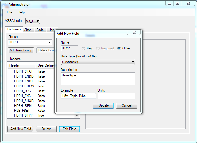

Add the definition to the KeyAGS dictionary
1. Select KeyAGS | KeyAGS Designer | Administrator.
2. From the new screen ensure the 'AGS Version' is set to the relevant version.
3. From the Dictionary tab set the 'Group' to the required table.
4. At the bottom of the page click 'Add New Field' and add the definition for the new field as required:
5. Apply the changes but ensure that they are saved (File | Save) before the dictionary is closed.
6. Create the file as before and now the definition will be in place to allow the conversion of the data the relevant definition to be added to the DICT table.
