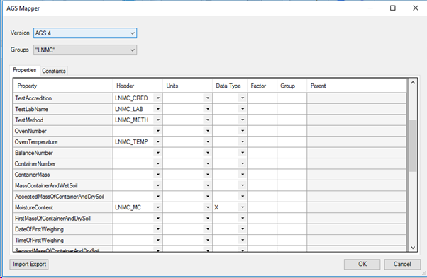

How do you report the new BS EN ISO 17892 Water Content test in KeyLAB and AGS 4 data?
Answer
The standard moisture content test can be used to report the new BS EN ISO 17892 Water Content test. There is no need to set up an additional test definition unless you want to for scheduling purposes.
You need to fix the number of decimal places for reporting on the input sheet so the value is saved to the database in the correct precision. Then in the AGS Mapper you need to set the data type of the MoistureContent field to be X rather than MC.
If you are reporting the testing method in your reports and AGS data you will also need to ensure that the testing method is selectable on the input sheet if you are currently conducting both test methods. If you have moved completely to the new standard, then you can simply change the testing method default value for the input sheet.
