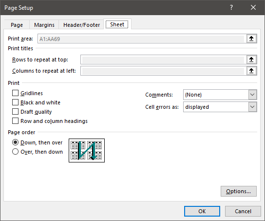

When printing the KeyLAB Output sheet, it always prints in black and white.
Process
We can change the default setting for the printing. We can change the print settings in the sheet designer. Then go to file then print, once there we need the page setup.
Once in the menu we need the sheet tab. There is a tick box for black and white in the print area.
.If this setting is checked then the sheet will always print in black and white.
