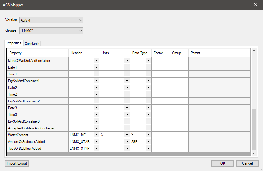

When creating a test sheet in KeyLAB there will always be an important element for the formatting for AGS export. This can be made simpler by using the AGS mapping to control the formats.
Process
When you open the mapping, you can select no data type, the format will be in the format on the sheet, so you can use excel fix functions to control the formats. This can work for a lot of sheets but on some it will cause a problem.
If you go into the Mapping a manually add the data type for the field you need, and make sure it's the type required KeyLAB will format the number to the format in the mapping.
