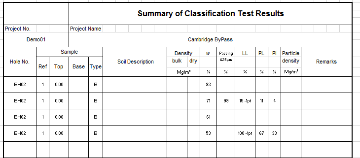

You can put the depths in as well but the most important part is the specimen reference. The image below shows the specimens for BH02. The two Atterberg limits are on specimen 2 and 4.

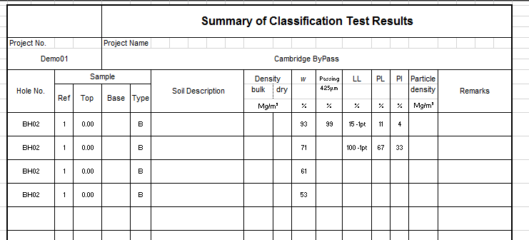

If you report this on the standard summary the report will look like the example below.
If you wish to put all the specimens together on the output sheet you will need to go to the sheet designer. In the output sheet you will need to put the reference cells for specimen reference for each test. When you do this you will get all the specimens in the correct place.
