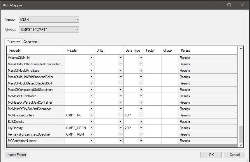

Process

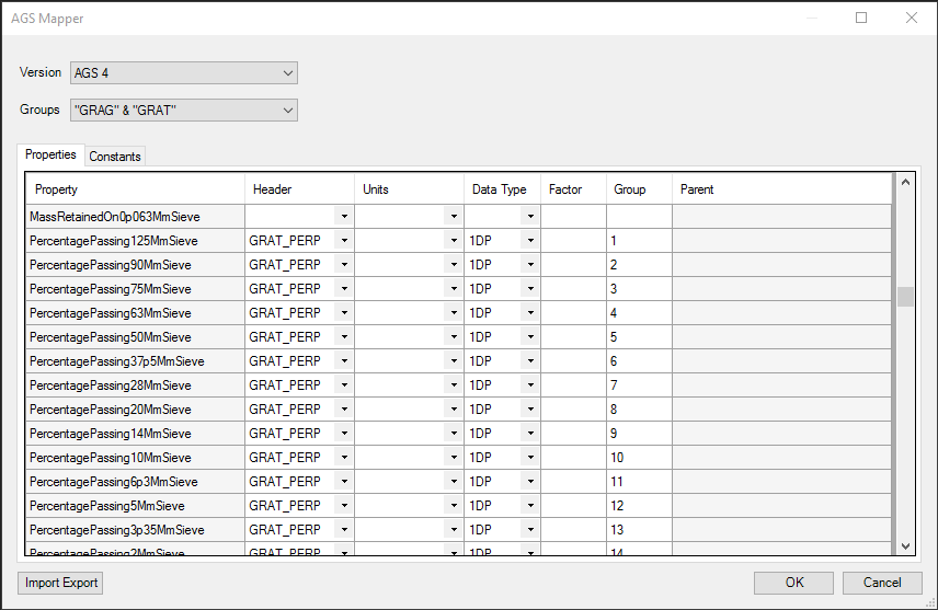

To add the grouping go to the AGS mapping of the test you want to group. On the image below there is a number of groups which are on the sieve sizes for the PSD.

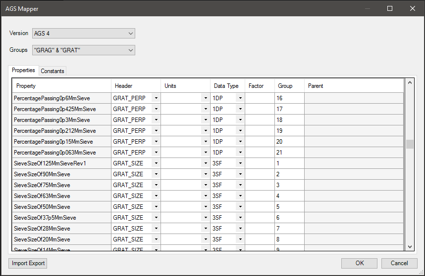

The group number tells KeyLAB what information to put on a new line for the same sample in the AGS file. In the PSD examples all the sieve sizes and the percentage passing values need to be on a separate line in the AGS as they all use the GRAT_PERP and the GRAT_SIZE headings.
Putting the sieve size and percentage passing for that sieve size in the same group (with a group number) will make put them on a separate line in the AGS.
