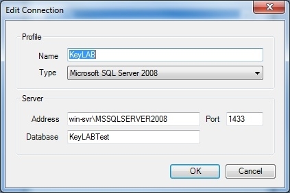

A new installation can be linked to an existing KeyLAB2 system from Connection | Connect.
Click Add and define the required details:
Supported Database systems
The following are both suitable systems for the underlying KeyLAB2 database -Microsoft SQL server 2008,2012 and 2014 (recommended).
Once defined, the new connection is then listed in the Connect view.
From here the connections can be managed. Note that it is possible to use this interface to connect to a different database.
