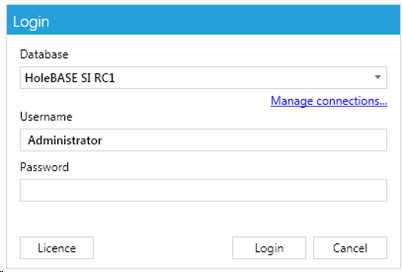

1. When you run HoleBASE SI for the first time you will see the login screen as shown below.

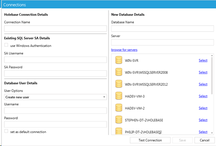

2. Click on the Manage Connections Link to open the connections window. This will display any connections you already have configured for HoleBASE SI. The first time you open this form it will be blank. Click Create Database button.
3. You will now see one of the largest forms in HoleBASE SI and you need to carefully complete each section. There are two sections for username and password. The first section, labelled SA details is the username and password for the SQL server user that has rights to create new databases. This is usually different from the main users details.
a. Connection Name:- This is the name the connection will be shown in the HoleBASE user interface. You can use any name for this parameter.
b. SA Username and Password: There are the details for the user that has permission to create a new database in the SQL server install and will have been provided to you by your IT department.
c. Server: This is the server name that the SQL server is running on. The server name should be the same as the server name you use to login into the SQL server management studio. If you are unsure and your IT department has the SQL browser installed on your server you can use the Browse button to locate your server.
d. Database Name:- This is the exact name for the database that you wish to setup in SQL server. It is recommended that you use HoleBASE SI as your default name.
e. Database Username and Password: Select "Create New User" and then add the user name and password, or select use an existing user by adding their username and password.
4. Click the Test Connection button to ensure that a connection can be made to the database and then click Save to create the database. The processing of creating the database and saving the information will also set up the connection to the server in this copy of HoleBASE SI. If you wish to connect other copies to HoleBASE SI to this server you need to follow the "Connecting to an existing HoleBASE SI database procedure above and you do not need to repeat this procedure.

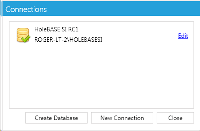

2. Click on the Manage Connections Link to open the connections window. This will display any connections you already have configured for HoleBASE SI. The first time you open this form it will be blank. Click New Connection to link to an existing database that has been set up for HoleBASE SI. Note: If you have not yet created a HoleBASE SI database then you need to click the Create Database button and follow the steps in the next section of this guide.

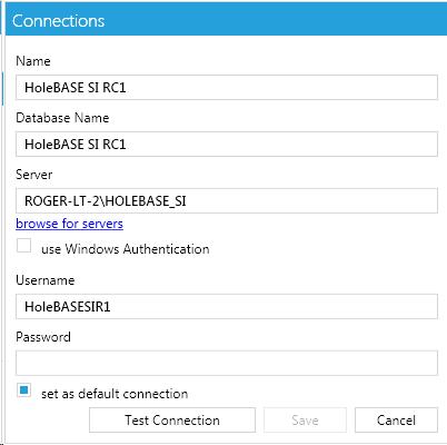

3. The Connections form will be displayed as shown below and you need to enter the following information that will have been supplied to you by your IT department.
a. Name:- This is the name the connection will be shown in the HoleBASE user interface. You can use any name for this parameter.
b. Database Name:- This is the exact name for the database that has already been set up within SQL server.
d. Username and Password: This will have been provided to you by your IT department or set up in the "create new database" procedure.
