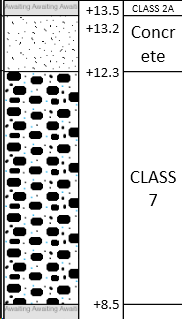

If a non-standard Hatch Pattern is used within HoleBASE SI then when this is drawn on a borehole log or a section, then the hatch pattern will return as 'Awaiting Image'. The below process will detail how to draw a new Hatch pattern and add this into HoleBASE SI. The below image and picklist item are not representative of real data.
It is possible to see whether a picklist item has an image by viewing the data in the grid. In the below example, 'Concrete' has an image whereas 'Class 7' does not.
This is then shown on the log as follows;

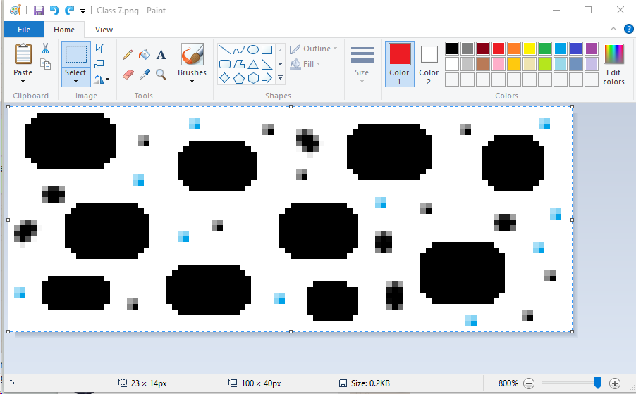

- Open an application that can create the drawings required, in this example Microsoft Paint will be used.

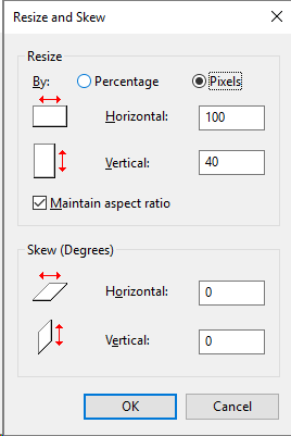

- Create a canvas for the correct size. In this example, 100x40 pixels is used.
- Draw or paste the required image into the canvas
- Save the image as a PNG file into a convinient location on the machine.

- As the images are tiled in HoleBASE SI, it is important to draw the image so that it is not bigger than the width of the legend bar on the template or strip, if this is the case then some of the image may be left off of the drawing. The standard size used in the default images are 100x40 pixels.
