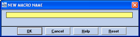

  7. Double-click in the Description for the first row, then highlight the words ‘Poorly graded SAND’.
  8. Select Tools->Write Text Macro. You see the NEW MACRO NAME dialog box:
  9. Enter ‘PGS’ and click OK.
  10. Click in another cell to close the Description pop-up box.
  11. Double-click in the Description in the second record. Highlight ‘fine to coarse sandstone gravel’.
  12. Select Tools->Write Text Macro. Enter ‘FCSG’ and click OK.
  13. Click in another cell to close the popup.
  14. Double-click in the third Description cell.
  15. Press F4, type ‘PGS’, press Enter, type a comma then a space, press F4, type ‘FCSG’, press Enter.
  16. The result is ‘Poorly graded SAND, fine to coarse sandstone gravel’
