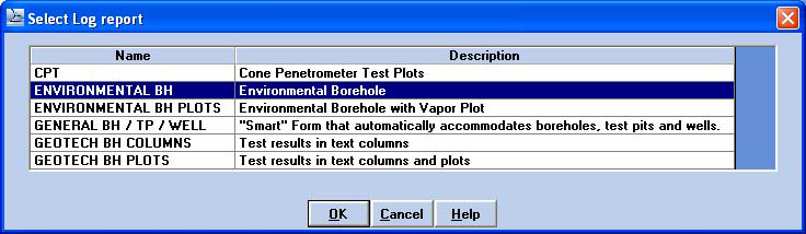

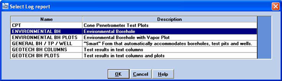

  3. Click the Graphical Data Input  icon or select Additional Modules->Graphical Data Input. The first time you use graphical input mode for the current project, you see a dialog box asking which log form you would like to use:
  4. Select the ENVIRONMENTAL BH form and click OK. You see the report form displayed on the screen.
    Note: To change to a different form, use the File->Select Report for Input menu option.

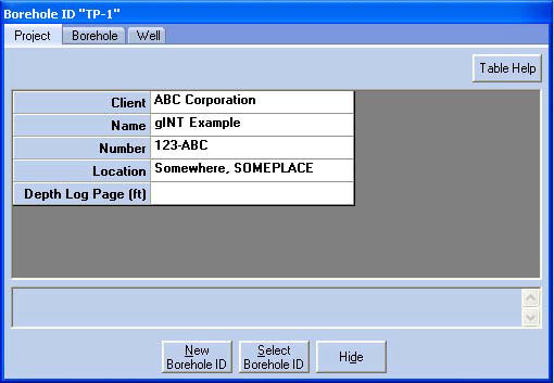

  6. Click the Client field in the report. A data entry window appears. Click the Project tab in the window if this is not currently showing.
  7. In the data entry grid, change Name to ‘Apple Tree Lane Retrofit’ and Number to ‘ATL-001’. Click Save. Notice that the Project Name and Project Number in the report preview change to the new values (you may have to drag the data entry window to one side or the other to see both changes).

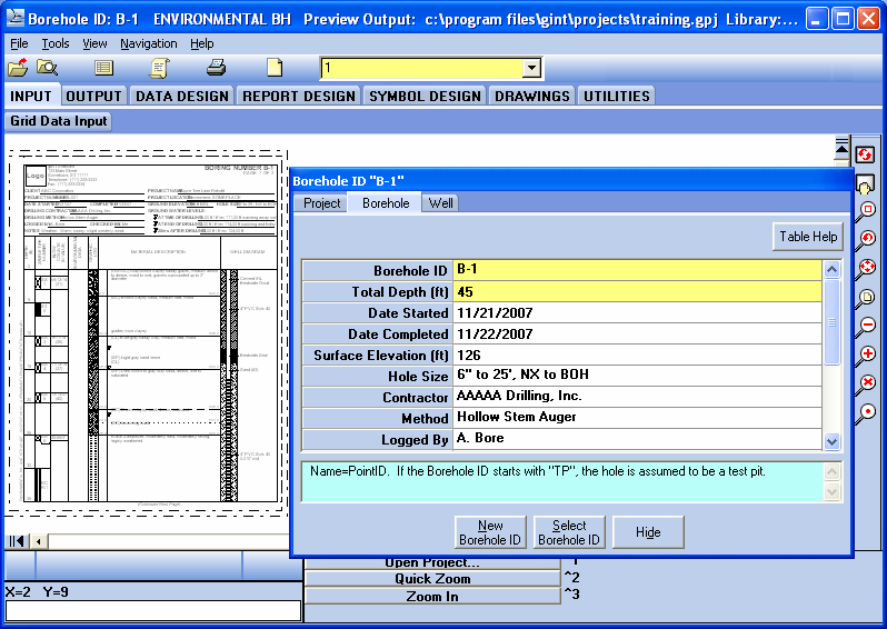

  8. Click the Borehole tab, then click the Select Borehole ID button. Select borehole ‘B-1’ and click OK. Notice that the preview now shows the monitoring well log report for borehole B-1 and the data entry window shows data for B-1 also.
  9. Click the Quick Zoom   icon and zoom in on the left side of the header again.
  10. Change the Date Started in the data entry window to ‘11/22/2007’. Click Save. Notice that the preview is redrawn with a Date Started of the revised date.

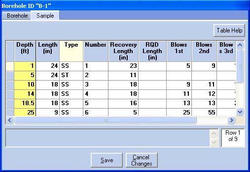

  11. Click the Zoom Out   icon. You should be able to see sample graphics and data in the Sample Type-Number and Blow Counts columns in the preview. Click in one of these two columns. A data entry grid for sample data for borehole B-1 appears.
  12. Change the Length in the first record to ‘12’ and the Type ‘GB’ (Grab Sample) and click Save. Notice that the sample symbol in the preview changes to a hand and the sample is half its previous length.
  13. Change the Length back to ‘24’ and the Type back to ‘SS’, then click Save. Notice that the preview is restored to its previous contents.

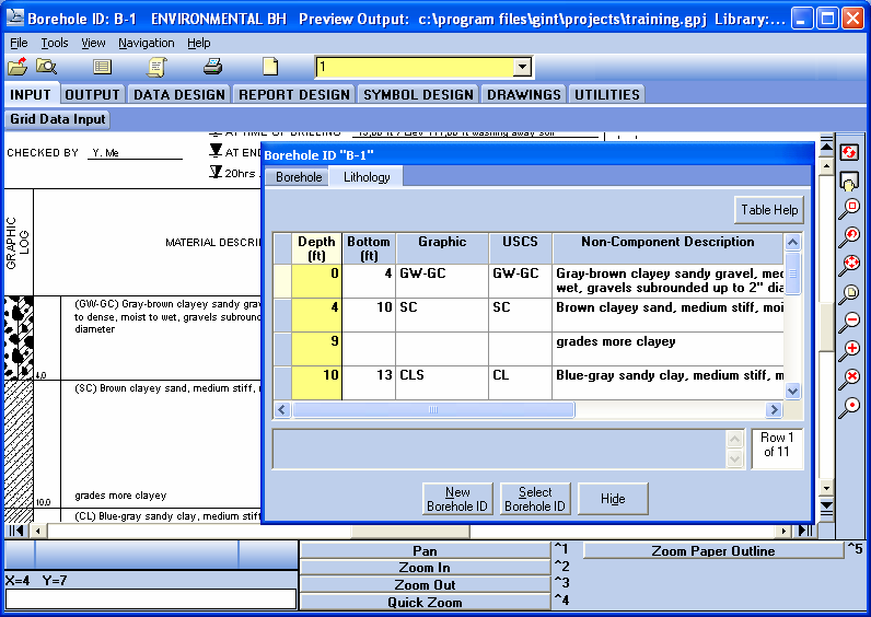

  14. Scroll the preview window until the Graphic Log and Material Description columns appear, and the contents of the first lithology layer are visible. Click in the Graphic Logcolumn. A data entry grid for the lithology layers for borehole B-1 appears.
  15. Change the Bottom of the first layer to ‘6’, and the Depth of the second layer to ‘6’, then click Save. The preview is re-drawn with a longer first layer and a shorter second layer.
