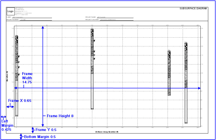

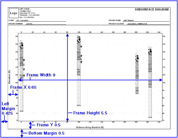

  4. Make note of the Left Margin and Bottom Margin values in the Main tab, and Frame X, Frame Y, Frame Width and Frame Height values in the Data Frame tab. If you have a printout, you can optionally draw these measurements on the report, as shown:

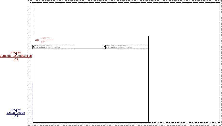

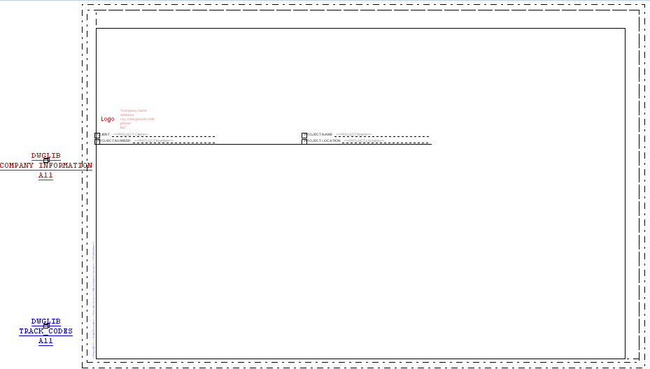

    Notice that the inserted block does not match the new outlines. We will create a modified version of this block.
  12. Hold down the Alt key and click on the block insert for the TITLE LANDSCAPE block. The block opens in DRAWINGS->Drawing Library.

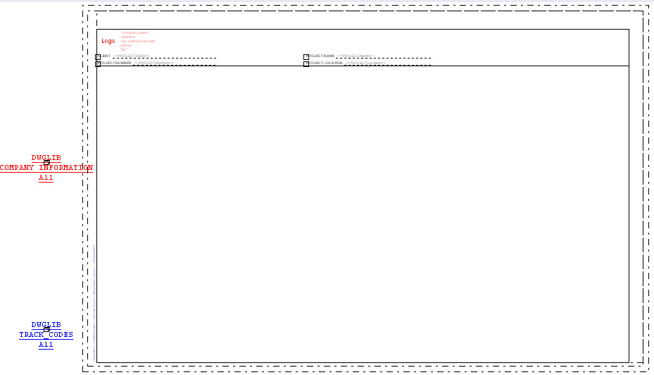

  15. Click the Properties   icon. Change the Page Size to ‘Ledger’ (or equivalent) and click OK. The page outlines are redrawn.

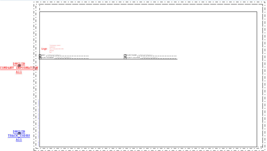

  16. Double-click on the right edge of the black, solid line, rectangular border. The POLYLINE PROPERTIES dialog box opens.

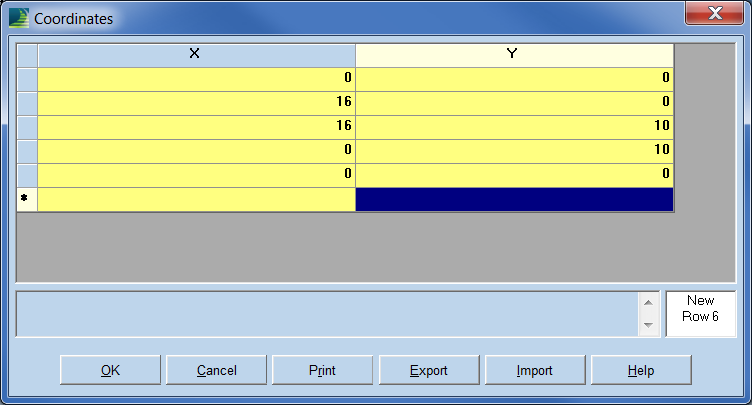

  17. Click the Expand   button to the right of the Coordinates property.
  18. Change the two ‘10.16’ X values to ‘16’, and the two Y ‘7.6’ values to ‘10’, then click OK.

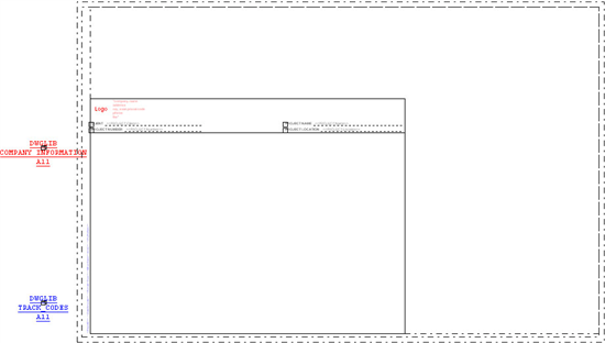

  19. Click OK to close the POLYLINE PROPERTIES window. Notice that the border is now consistent with the new size, but other entities aren't.

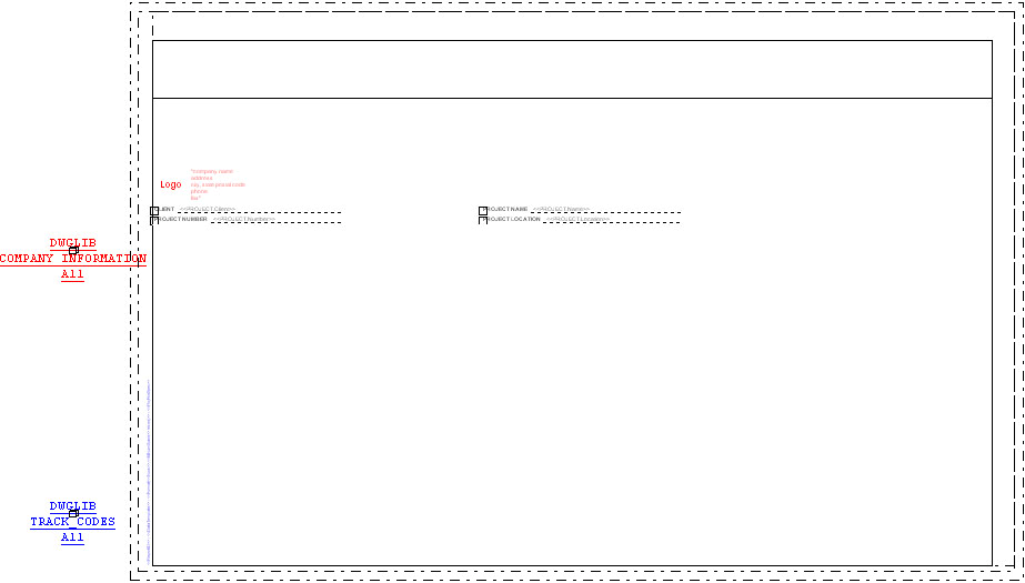

  20. Double-click on the horizontal line that normally separates the heading from the body. Click the Expand   button to the right of Coordinates, replace the ‘10.15’ X value with ‘16’ and the two ‘6.5’ Y values with ‘8.9’, then click OK. This places the line in the desired location.
  21. Double-click the red COMPANY INFORMATION block insert. Change the Offset Y value to ‘9.655’. This moves the COMPANY INFORMATION block up by 2.4" in the current drawing.
  22. Select Modify->Offset Move. Select the four header text entities (CLIENT, PROJECT NUMBER, PROJECT NAME, PROJECT LOCATION), enter ‘0, 2.4’ in the Change X,Y  box at lower right, then click the OK button above this box.

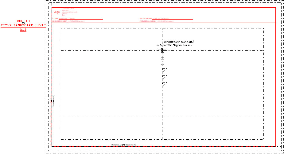

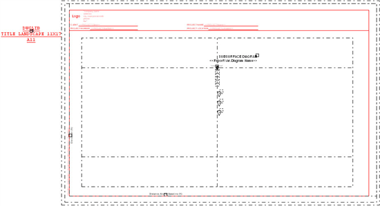

  26. Select Blocks->Insert Block. Click the Expand   button to the right of Block Source, select a Type of ‘DWGLIB’ and a Block of ‘TITLE LANDSCAPE 11X17’. Click OK to close the Block Source dialog box.
  27. Change the Offset X and Offset Y values to ‘0’, then click OK. Move the block insert with the mouse to a position just to the left of the report, and click to finalize its location. The block is now inserted.

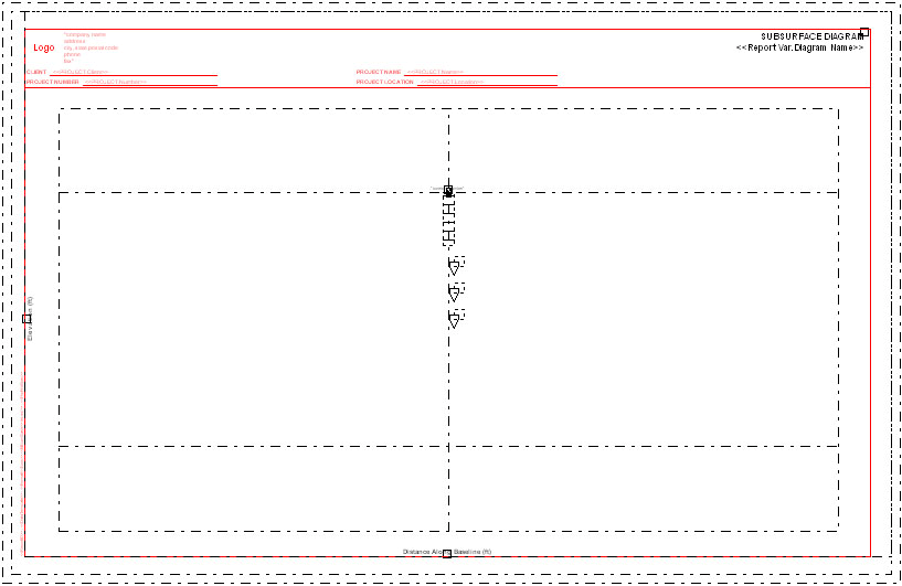

  28. Double-click the SUBSURFACE DIAGRAM text block. Change X to ’15.9’ and Y to ‘9.95’, then click OK.
  29. Double-click the ‘Elevation (ft)’ text block along the left edge. Change Y to ‘4.5’ and click OK.
  30. Double-click the ‘Distance Along Baseline (ft)’ text block. Change X to ‘8’ and click OK. This completes the report design.
