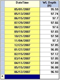

A hydrograph is a record of water levels vs time. gINT allows you considerable flexibility to create input tables as well as to design reports to meet your needs. Your input table can be as simple as the following:
Hydrograph Input Table example.jpg (33.68 KiB) Viewed 175 times

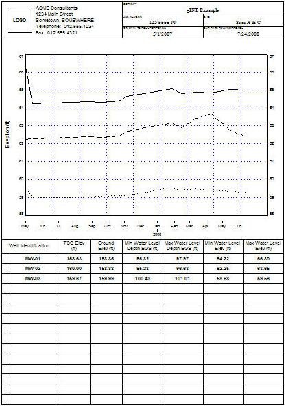

You can setup the report for one reading a month or multiple readings per month and you can also plot the data for multiple monitoring wells. In addition, you can select to display all of your data or just a portion of the data that has been entered.
Hydrograph Output example.jpg (76.17 KiB) Viewed 175 times
