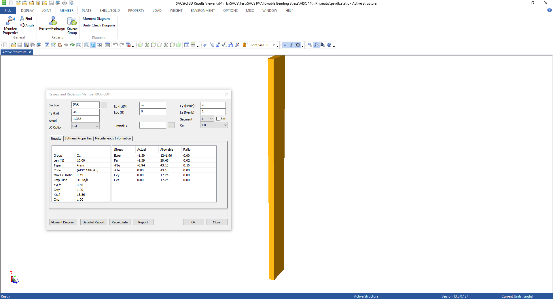

Let's take a look at the following simple example in SACS.
We have a 12"x3" prismatic section with an unbraced length of 1 ft, so it won't be subject to any lateral torsional buckling. I've used the section property calculations provided in the back of the AISC manual for rectangular sections.
Sy = bd2 / 6 = 3in . (12in)2 / 6 = 72 in3
Zy = bd2 / 4 = 3in . (12in)2 / 4 = 108 in3
Zy / Sy = 108 in 3 / 72 in 3 = 1.5
Ft = Fy / Ωt = 36 ksi / 1.67 = 21.5569 ksi
Fb = AMOD · Ft · Zy / Sy = 1.33 · 21.5569 ksi · 1.5 = 43.10 ksi
As you can see, the reported allowable bending stress is indeed the ratio of plastic section modulus to the elastic section modulus multiplied by the allowable stress modifier and the allowable tensile stress.
