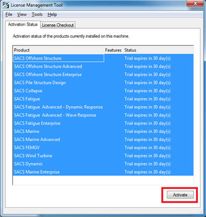

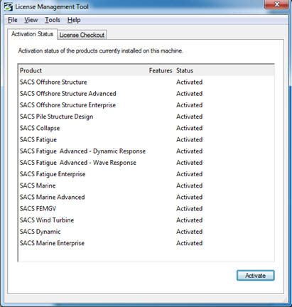

After Installation, SACS products must now be activated. SACS products DO NOT support trial license status. Launch SACS 10.0. The following dialog will appear. Click on the “Bentley License Tool…” button.
Select all the SACS license products and click the “Activate” button.
The system will activate the licensed products.
