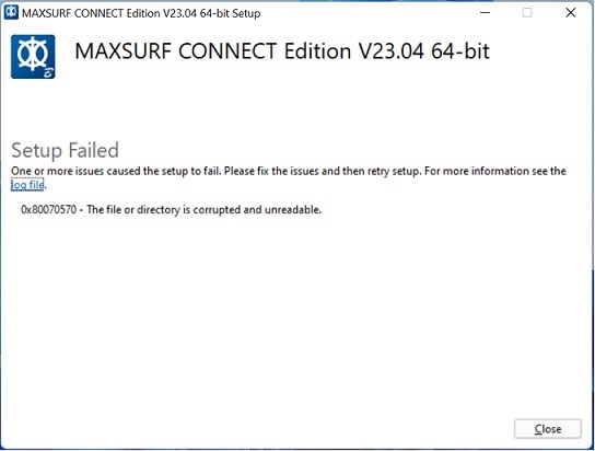

When I install MAXSURF, I get the error "Setup Failed with error code 0x80070570"
 Product(s):MAXSURF
 Version(s):All
 Environment: N/A
 Area: Installation
 Original Author:Payel Sasmal, Bentley Technical Support Group
Problem Description
I have successfully downloaded MAXSURF. When I start the installation, I get the following error:
The error 0x80070570 is related to corrupted media. Download the file again and disable any antivirus/security software prior to install again. Try to use a different Web Browser (like one of the Microsoft Web Browsers) to download the file again.
