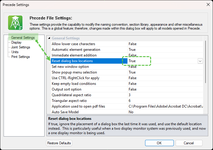

This issue happens when a user changes from a double-monitor system to a single-monitor system.
Precede stores the last location of the dialog, and if it was on the second screen, it will have issues on a single screen.
You will need to reset the dialog's default location. Open Precede, then select the "Precede Settings" and then check the "Reset dialog boxes to default locations" checkbox.
