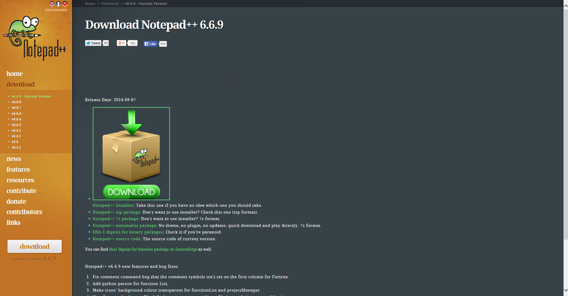

Step 1: Download and Install notepad++
Navigate to http://notepad-plus-plus.org/download/  and click the download button.
Once the program downloads, run the installation.

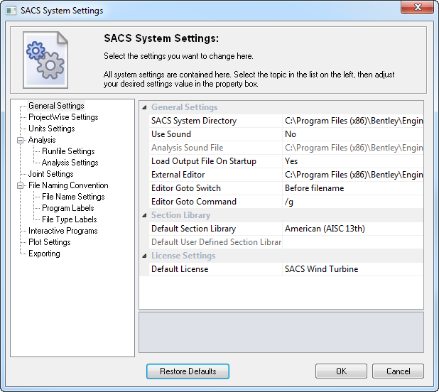

Step 2: Change the Default Editor in SACS
Open the SACS Executive and navigate to the General Setting in SACS Settings. Your setting should look something like this:

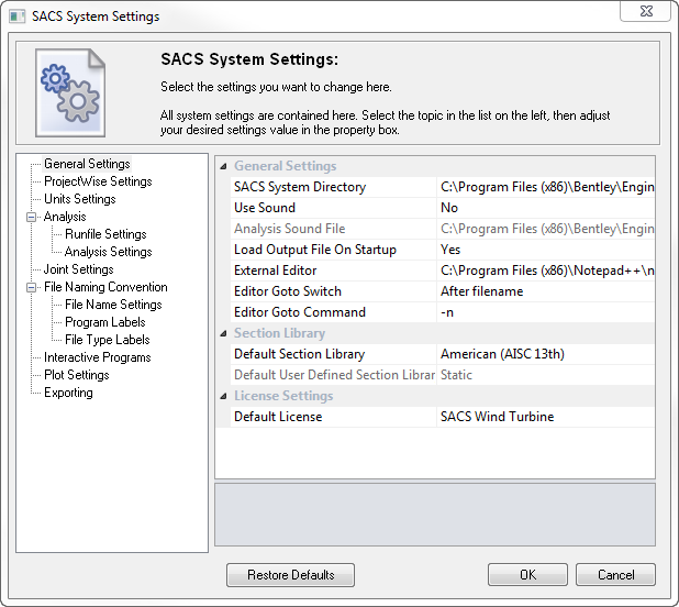

Select the External Editor setting and click the ellipses (…) to open a file dialog. Then navigate to the installation folder for Notepad++ and select the notepad++.exe executable.
Modify the Editor Goto Switch to After filename and the Editor Goto Command to –n. Now the your General Settings should look something like this:
Text Editor Usage
Now when opening listing files through the SACS Executive or generating reports from Precede, Notepad++ will open instead of the included SACS text editor.
Also, clicking on warning or error messages in the error log will cause the listing file to open at the error line in Notepad++.
