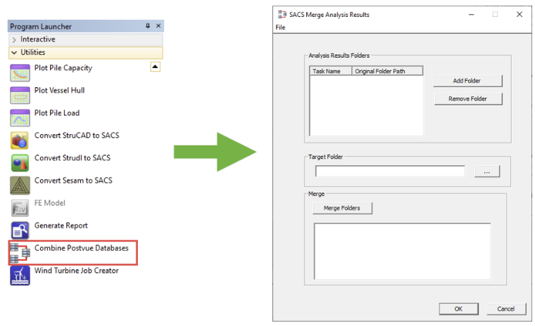

The Combined Postvue database tool is in the Utilities tab of the program launcher in SACS Executive.

1. Go to the Utilities tab to launch the "Combine Postvue Databases".

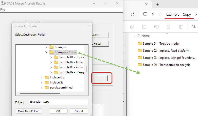

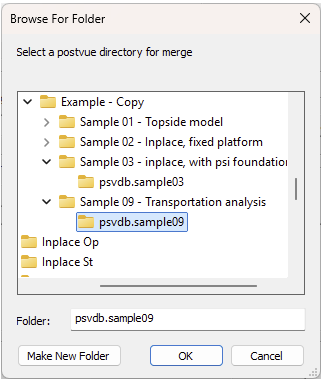

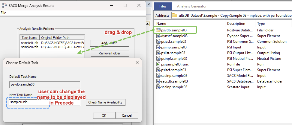

2. Use the "Add Folder" button to add the psvdb. folders. Here, the user needs to navigate to locate the Postvue database folder and grab the folder one by one for each analysis.
But the simpler way is to drag and drop (can be done in SACS 14th onwards). The user can change the Task name for each file for easier reference in Precede afterward. The Task Name is going to be displayed on the postvue results output that we're viewing in Precede.

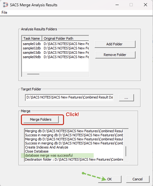

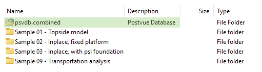

3. Specify a target path where the user wants the resulting psvdb database, the combined postview database, to be output.
4. Lastly, clicking on the Merge Folders will combine all the PSVDB files. folders.

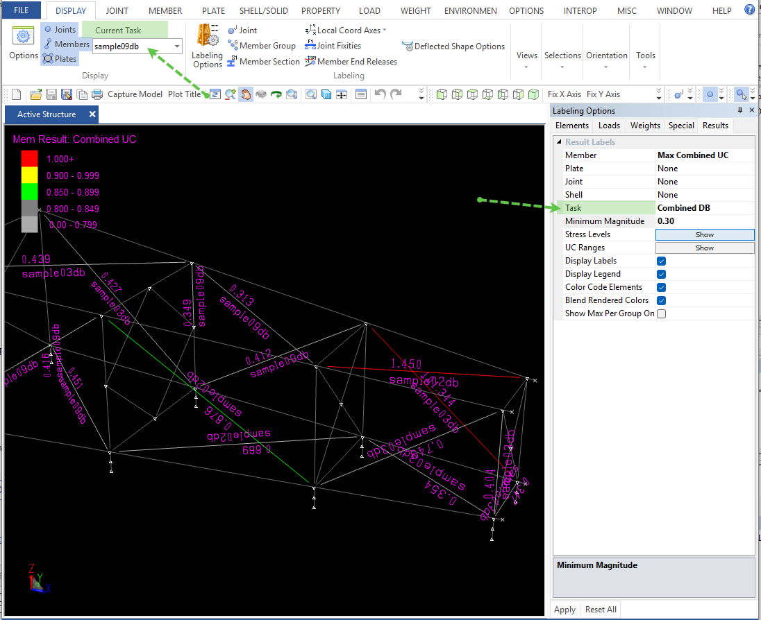

5. Results:
DISPLAY tab > Display > Current Task - control the display of the model in reference to the task.
DISPLAY tab > Labeling > Labeling Options > Task - control display result labels
