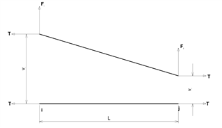

First let's consider an cable element with lateral loads at each end.
Cable Element
The formula for the relative deflection between the ends would be:
And static equilibrium requires that:
The resulting geometric stiffness matrix is:

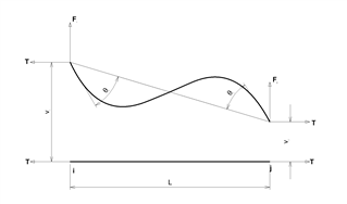

Now if we consider a deformed beam element.
Beam Element
The deformed shape of the frame element, h(x), can be expressed as:
The slope of the element is the derivative of the shape with respect to x:
Assuming small rotations the end displacements and rotations at each end of the beam can be solved as:

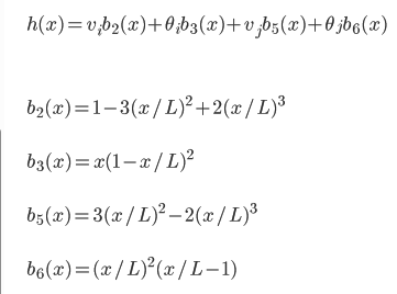

The cubic deformation function can also be written as a weighted sum of cubic polynomials:
where:

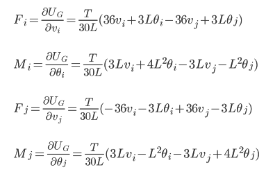

Using Castigliano's theorem, the partial derivative of the geometric strain energy function with respect to a displacement coordinate yields the force of that displacement coordinate. The end forces for each coordinate can be expressed as:
This expression can be rewritten in matrix form which gives us the geometric stiffness matrix:
Geometric Stiffness Matrix
