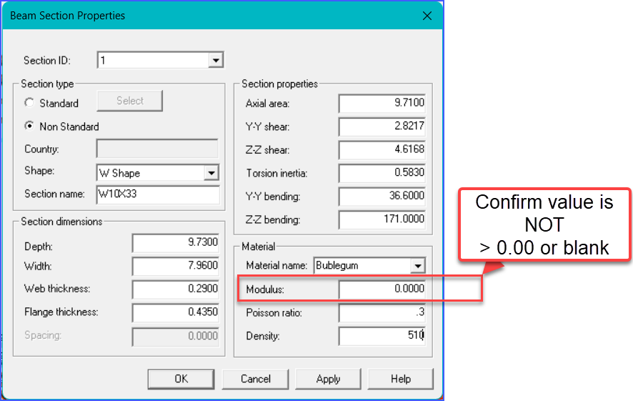

E2164-112:The value of "Modulus" must be greater than zero for following beam section material(s)
The following appears in the model consistency check report:
* * * E R R O R - MODEL * * *
STEEL
How to avoid it and fix it?
This message will usually appear when:
    1. Importing a model into AutoPIPE
    2. Performing a Model Consistency check
    3. Runing an analysis
The beam materials that are listed have Modulus values that are either 0.00 or blank, and the system can't work with these numbers.
Suggest opening up all the Beam Section IDs in your model that have one of these materials and check to make sure the Modulus value is greater than 0.00 and not blank. When you find each one that has this problem, go ahead and update those Beam Section IDs by changing the Modulus value to whatever numbers make the most sense for your specific project.
Note: May be combined with E723-23: System is not complete for analysis purposes
