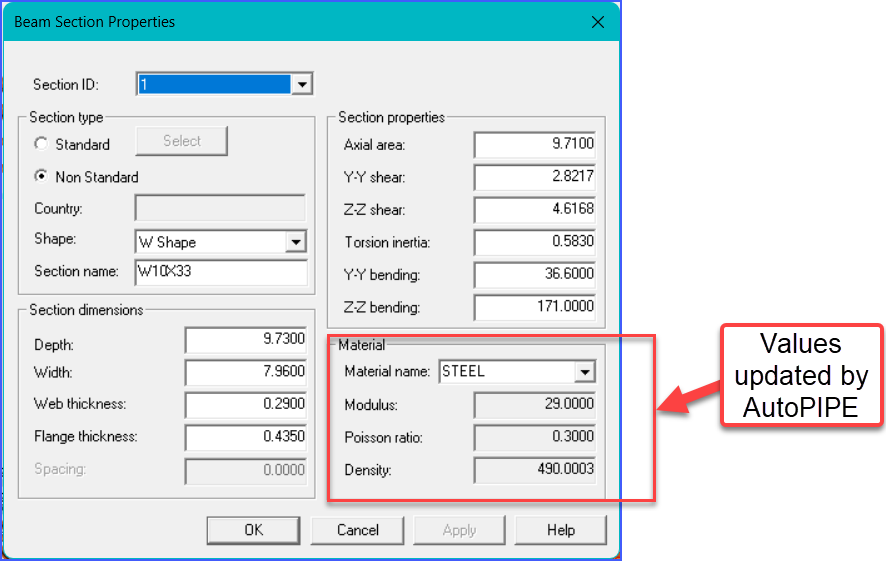

W2164-111: Reset properties to defaults for following beam section material(s)
The following appears in the model consistency check report:
* * * W A R N I N G - MODEL * * *
STEEL
How to avoid it and fix it?
This message will usually appears when:
    1. Importing a model into AutoPIPE
    2. Performing a Model Consistency check
    3. Runing an analysis
 Do not worry though — there is typically nothing needs doing right away. It is just a warning to inform the user some material ID properties were reset to their default values.
Suggest opening up all the Beam Section IDs in the model that use this material and check out the default values that the program set. If anything looks wrong or different from a desired value, go ahead and change those Beam Section IDs to whatever values work best for your project.
Note: May be combined with E723-23: System is not complete for analysis purposes
