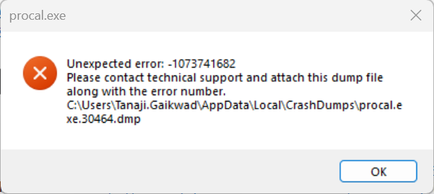

The following message appears in AutoPIPE Vessel while analyzing the model, how to avoid it?
Unexpected error: -1073741682
Please contact technical support and attach this dump file along with the error number.
When creating a new project in AutoPIPE Vessel and attempting to run calculations, the analysis may fail and display an unexpected error message from the calculation engine (procal.exe).
Scenario 1: Nozzle Corrosion Allowance Exceeds the Wall Thickness
For one or more nozzles, the specified corrosion allowance may be equal to or greater than the nozzle wall thickness.
For example, if a corrosion allowance of 3 mm is specified and it exceeds the applicable nozzle wall thickness, the calculation can result in a division-by-zero condition, causing procal.exe to terminate unexpectedly.

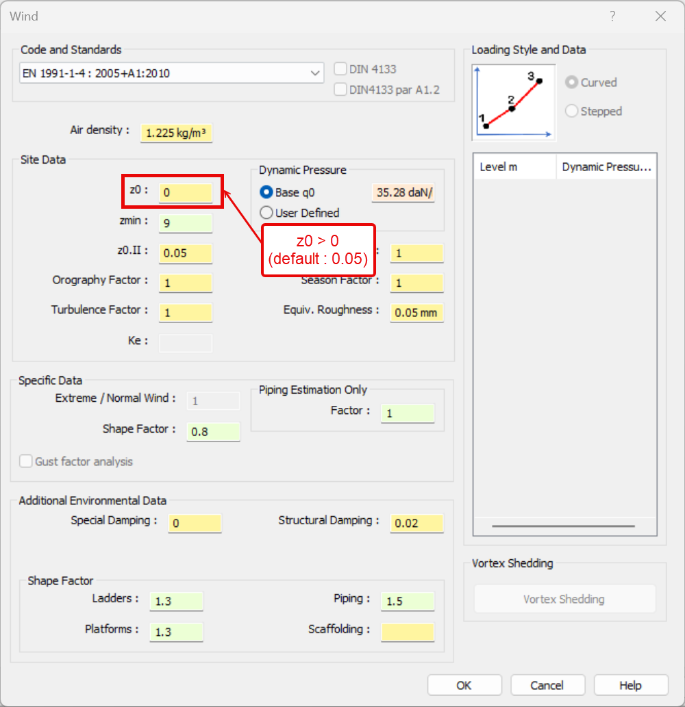

Scenario 3: Invalid z0 Value in Wind Loading Data
The issue is caused by an invalid user-defined value in the Wind data input.
Specifically, the parameter z0 (roughness length) is set to 0, which is not a valid value for the selected wind code.
When the calculation engine processes the wind loading data, the invalid value causes the calculation program (procal.exe) to terminate unexpectedly.
Resolution:
Verify the Wind loading parameters and ensure that the z0 value is greater than zero.
Steps to resolve:
    1. Open the model file.
    2. Navigate to Loads > Wind (or open the Wind dialog box).
    3. Locate the z0 field under Site Data.
    4. Check the entered value.
    5. If z0 = 0, replace it with a valid value greater than zero.
    6. The default value is typically 0.05.
    7. Save the model.
    8. Re-run the calculation.
