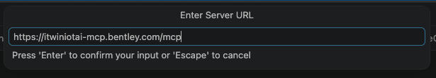

1. Open the Command Palette (Cmd + Shift + P on MacOS and Ctrl + Shift + P on Windows)

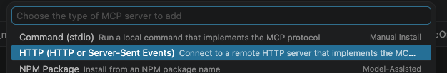

2. Type in MCP: Add Server
3. Select HTTP
4. Enter the URL for iTwin IoT's MCP server: https://itwiniotai-mcp.bentley.com/mcp

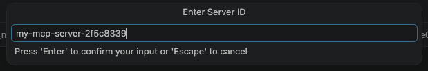

5. Enter any name for the server ID, this is merely for presenting a generic name for this MCP connection

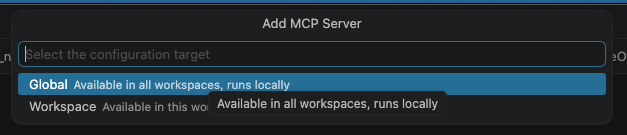

6. Choose Global setting

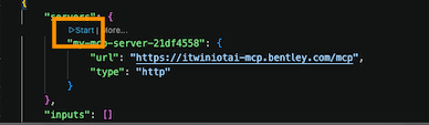

7. mcp.json will open, click the "Start" button above your MCP server entry
7. Click Copy URLs & Proceed once that dialogue opens

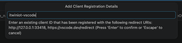

8. Enter the Client ID: itwiniot-vscode
9. Leave the Client Secret empty and press enter

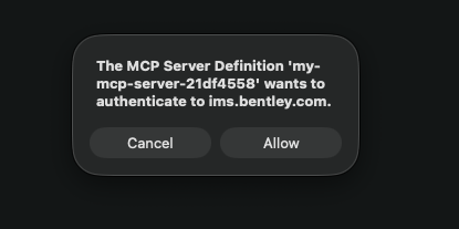

10. Click Allow
11. Authenticate with your Bentley IMS account

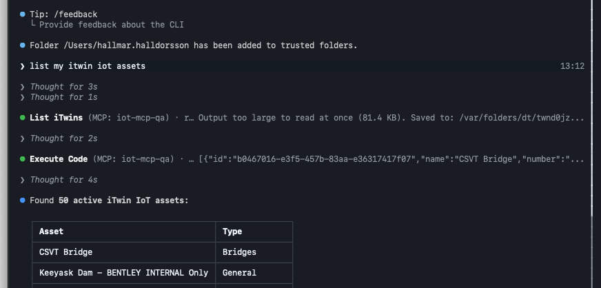

Github Copilot CLI
For general user guide on using Copilot CI please read through Github documentation here: https://github.com/features/copilot/cli/
1. Open your Command or Terminal window
2. Type in Copilot
3. Authenticate if needed
4. Type in your command with iTwin IoT as a context
