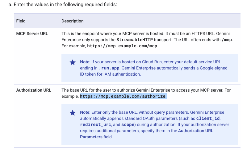

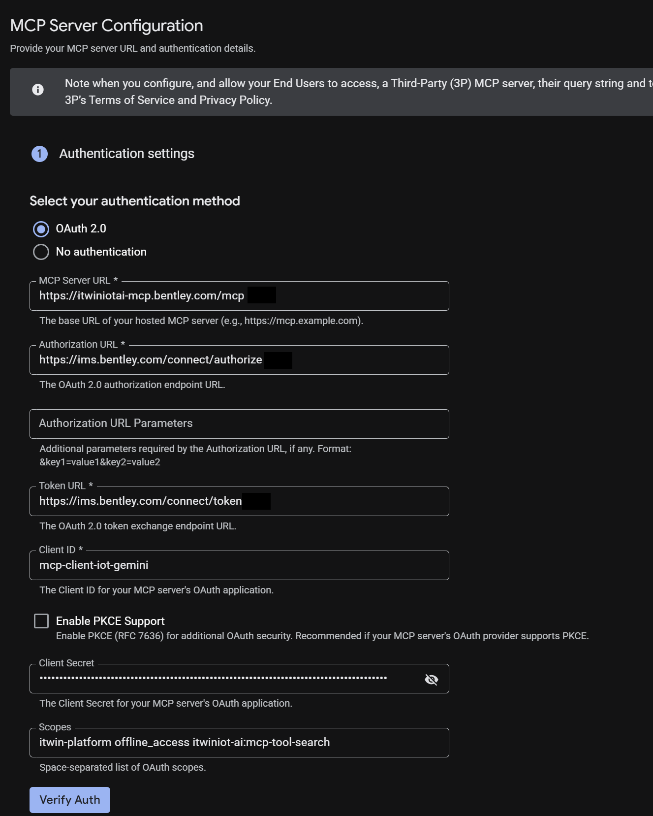

The first step is to set up the custom MCP Server connector for your organizations Gemini Enterprise account. A guide to set that up is shown here by Google. The URL for iTwin IoT's MCP server is https://itwiniotai-mcp.bentley.com/mcp and for Authorization it is https://itwiniotai-mcp.bentley.com/authorize
Client secret is an optional field
The client secret is optional.

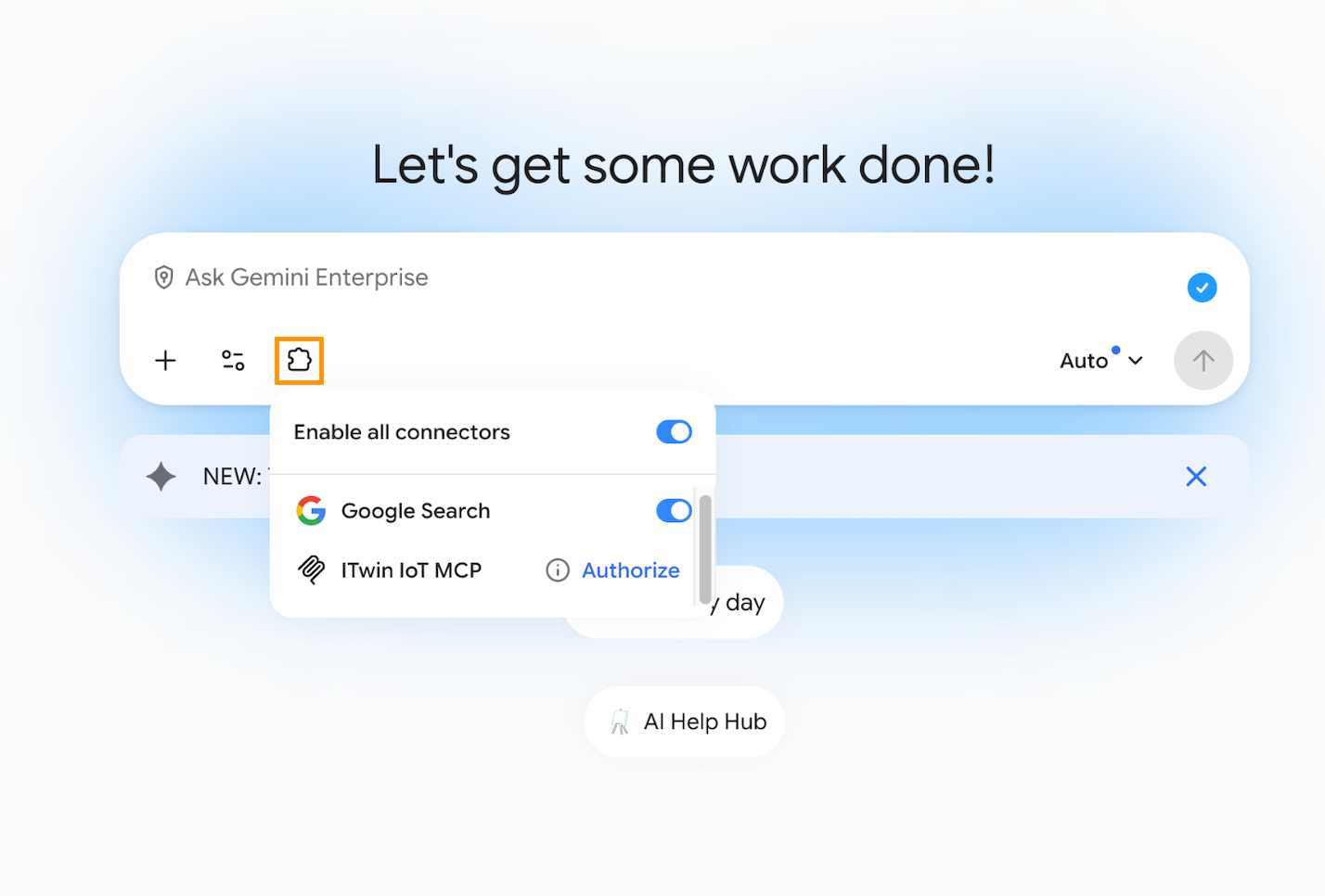

Once your Gemini Enterprise admin has done that you can enable the iTwin IoT MCP server connection by going to your Gemini chat, clicking the Connector icon and authorizing your iTwin IoT account via the iTwin IoT MCP connector.
