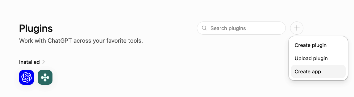

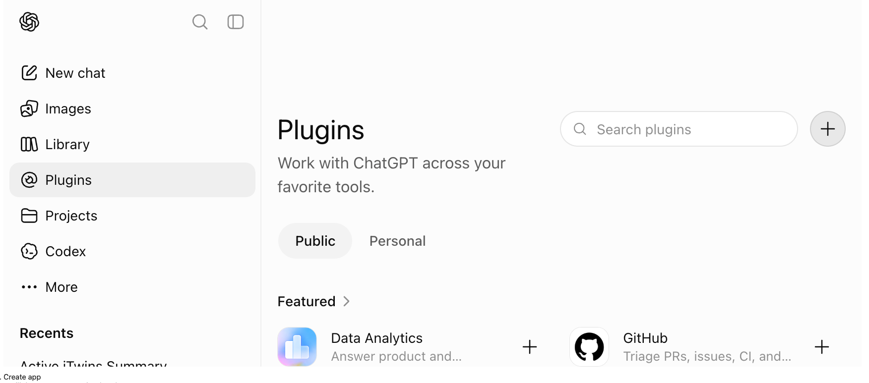

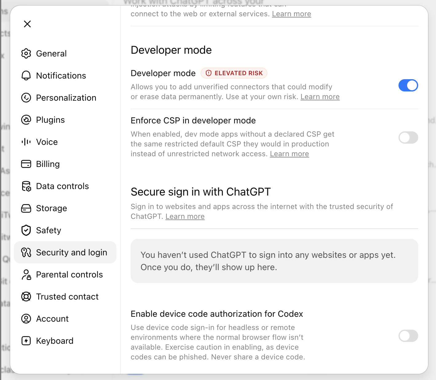

1. On the ChatGPT web app, open Settings > Security and login > Developer mode and toggle on Developer mode
2. Navigate to Plugins and click the + symbol

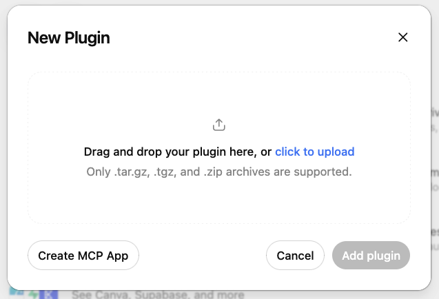

3. Select Create app, then click on Create MCP App

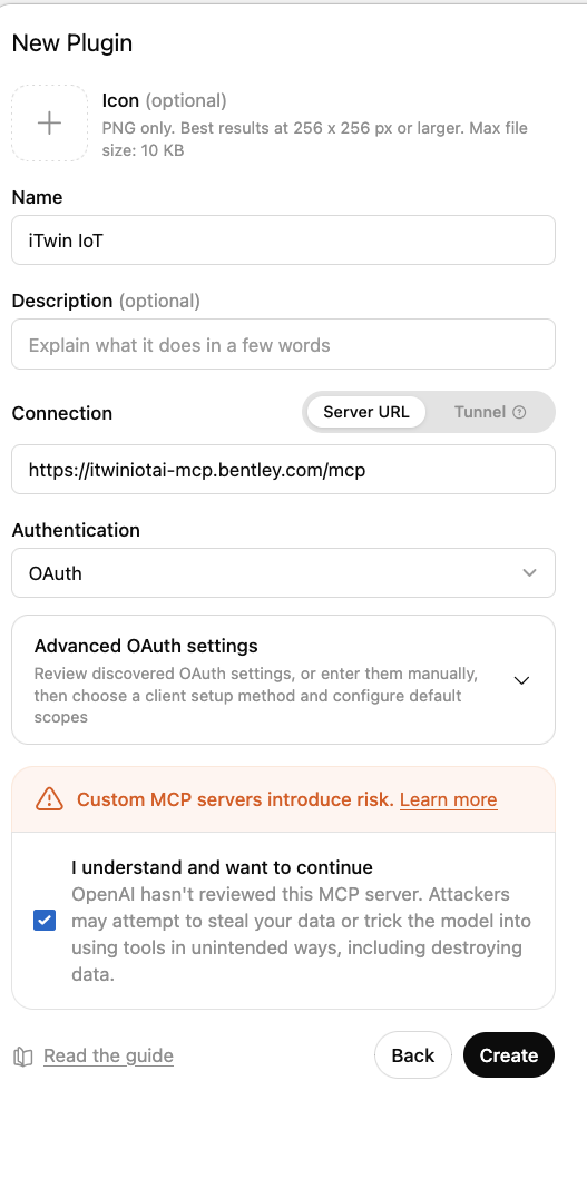

4. Type a representative name such as iTwin IoT, and use the MCP server address https://itwiniotai-mcp.bentley.com/mcp

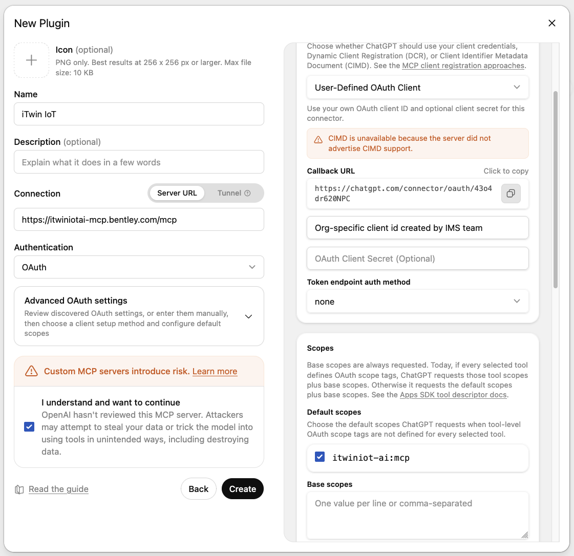

5. Click Advanced OAuth settings and select the registration method: User-Defined OAuth Client and fill in the OAuth
Client ID, using the naming convention itwiniot-chatgpt-{org/user}. Each organization or user must request its own Bentley Systems' IMS client ID because ChatGPT supplies a connector-specific redirect URI (Callback URL in the screen below). Copy the Callback URL and the Client ID used, and send them to us to enable your access. Make sure the checkbox next to "I understand and want to continue" is checked, then click Create. You won't be able to authenticate and use the MCP server at this stage.

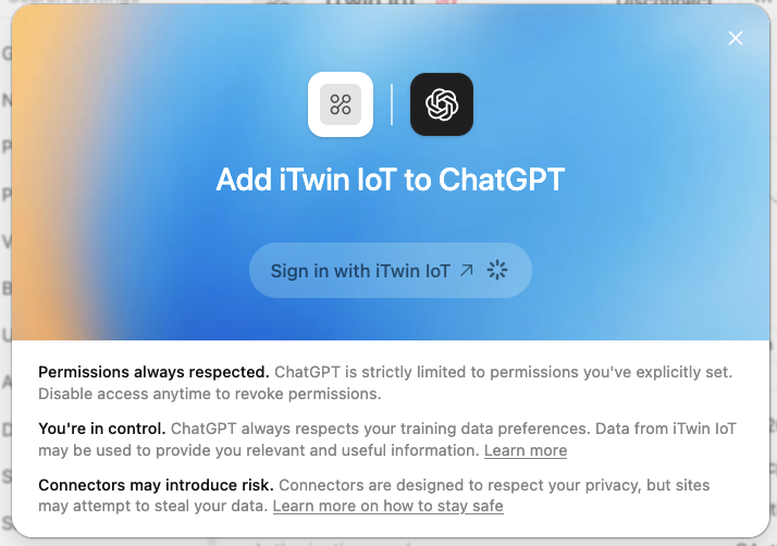

6. Provide Bentley Systems' IMS with the Client ID (such as itwiniot-chatgpt-{org/user}) and the exact redirect URI ChatGPT supplies. Once IMS registers your client ID and the provided redirect URI, you will be able to authenticate and use the MCP server.
Once you have set up the MCP server, you can use OpenAI to utilize the MCP server functionalities.
