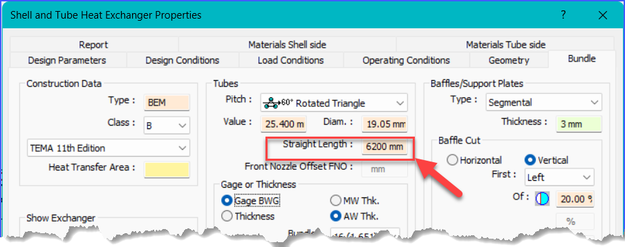

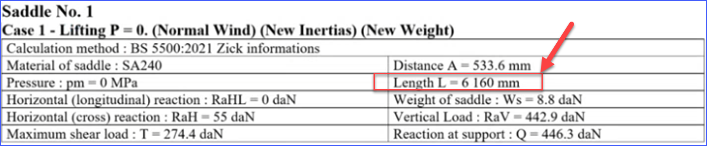

The length value is measured from the face of the tubesheet as shown below.

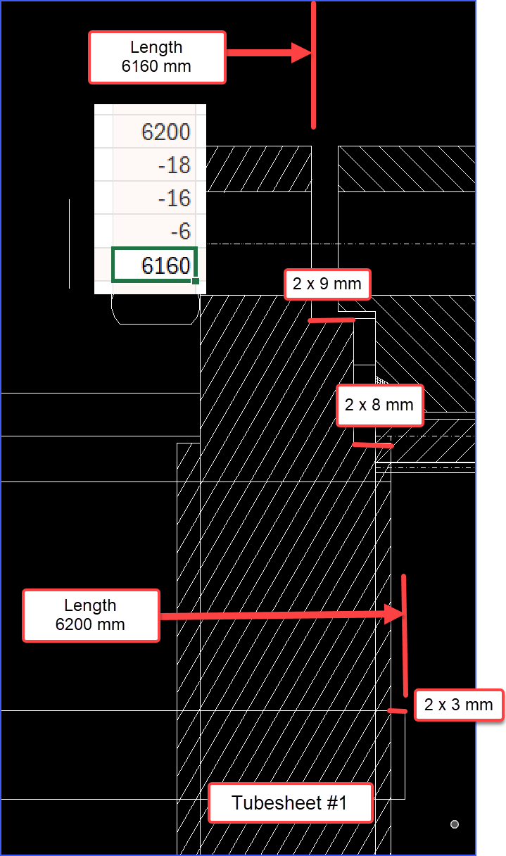

This measurement is based on the total tube length specified in the model and subtracting the various dimensions back to the face of the tubeshet.
Example:
Give a bundle length = 6200 mm

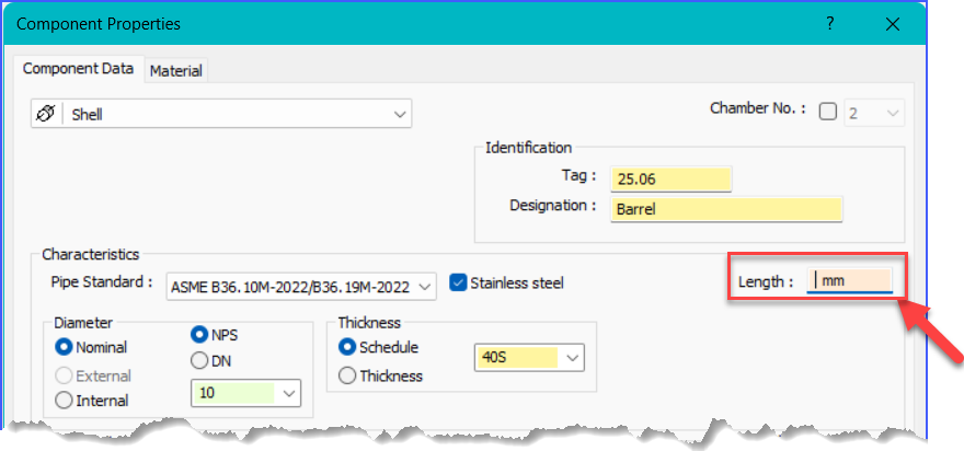

Keep the Shell Component Length empty:

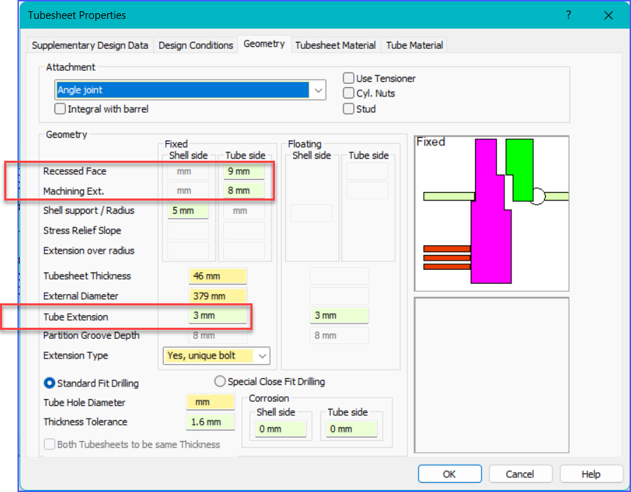

And Tubesheet dimension settings:
Subtract total dimensions for Tubesheet #1 and #2, from the total Tube's Straight Length
