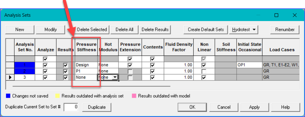

Regardless of piping code used in a model, Pressure Stiffening is enabled / disabled on the Static Analysis set dialog:
When the Pressure Stiffening setting is not set to "None", the program updates the bend flexibility calculation by dividing each k-factor by:
