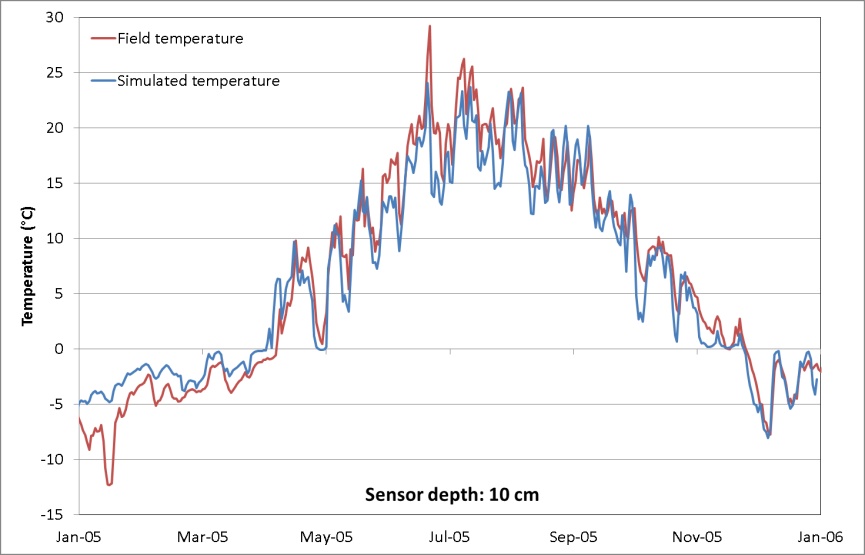

The surface energy balance (SEB) boundary condition in TEMP/W was used to simulate the thermal response of two capillary barrier soil covers overlying municipal waste. Both covers are comprised of the same materials; however, one cover faces north while the other south. The simulated responses are compared to field measurements to explore the effect of slope direction on the thermal response within the cover systems.
