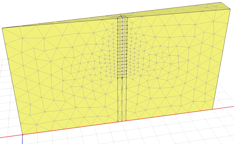

Artificial soil freezing is used in many engineering projects to excavate and construct mine shafts, tunnels, or other underground structures through water bearing, often unstable, soil formations. Similar to the two-dimensional Mine Shaft Freezing example, this example demonstrates a procedure for modeling the freeze wall growth for a mine shaft project. Freeze pipes are installed at equal distances to create a frozen barrier encircling the mine shaft. In this example, particular attention is given to the three-dimensional heat transfer at the bottom of the freeze wall.
