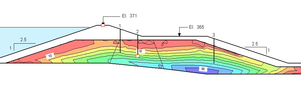

In light of the importance of the San Fernando Dam case histories and their prominence in the literature, it is important to show how GeoStudio, and in particular QUAKE/W, can be used to analyze cases like this. This example concentrates on the Upper Dam. The purpose here is not to replicate all that has been done by others, or to necessarily adopt the exact conditions presented by others, but to more generally illustrate the features and capabilities of GeoStudio in the context of a famous case history. The emphasis here is on QUAKE/W because the cases involve earthquake shaking, but SEEP/W, SLOPE/W and SIGMA/W are also used for various aspects of the analysis.
