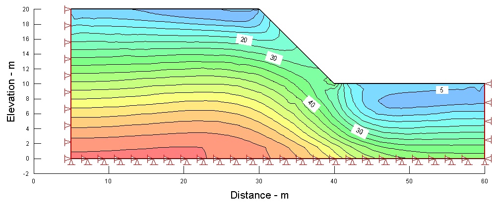

This example demonstrates how the results of a QUAKE/W analysis can be used in conjunction with SLOPE/W to estimate the permanent deformations that may occur as a result of the inertial forces associated with an earthquake. This type of permanent deformation analysis is referred to as a Newmark analysis. The premise of a Newmark analysis is that during an earthquake, there will be short moments in time when the inertial forces (mass times acceleration) plus the initial static forces will exceed the available shear resistance and during these times the temporary loss of stability will lead to unrecoverable deformations. The accumulation of the un-recoverable deformations will manifest itself as permanent deformation after the shaking has stopped. The details of the implementation for this type of analysis are presented in the SLOPE/W Engineering Book. Only the highlights of an illustrative example are presented here.
