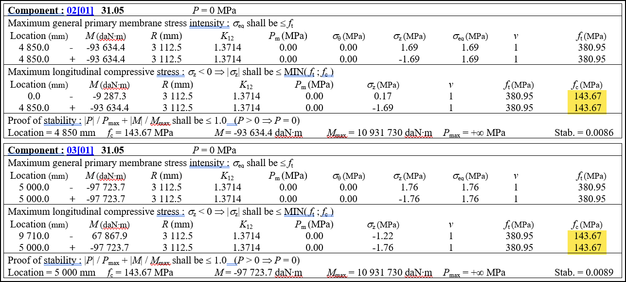

Example:
In this case (Erected, New Inertia, New weight), You can see AutoPIPE Vessel report value is matching with the manual calculations.
AutoPIPE Vessel Report:
Manual Calculations:
Parameter Value
K 1.35
e 25 mm
E 212000 MPa
Dm 6225 mm
fc 143.67 MPa
