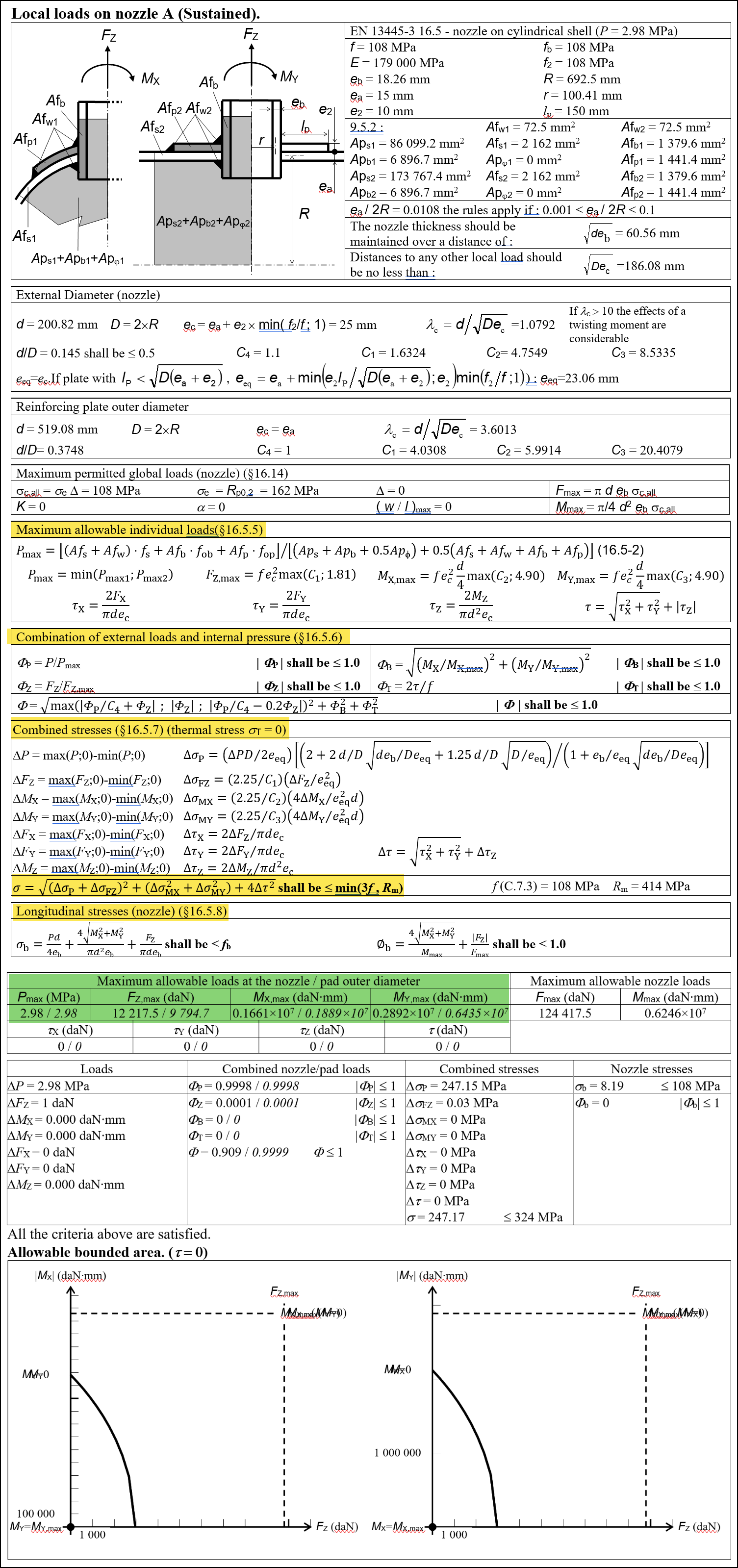

AutoPIPE Vessel is primarily designed to verify the nozzle load, not to calculate an allowable nozzle loads.
The software evaluates user-defined external loads and verifies whether the resulting local stresses satisfy the requirements of the selected design code (EN 13445, PD 5500, WRC 107/537, and others).
The analysis process is:
Applied Loads → Calculated Stresses → Code Compliance Verification
AutoPIPE Vessel performs local stress calculations and code compliance checks for the applied loads but does not automatically generate a comprehensive allowable nozzle load table suitable for fabrication drawings or mechanical datasheets.

EN 13445-3 Example
For nozzle local load assessment according to EN 13445-3 Clause 16.5.5, AutoPIPE Vessel calculates individual allowable load parameters used in the code equations, such as:
These values represent individual load limits only and are not intended to be applied simultaneously.
Therefore, compliance is based on the combination of applied loads rather than any single allowable force or moment value.
PD 5500 Annex G
PD 5500 Annex G follows the same fundamental methodology as EN 13445 and evaluates nozzle qualification using interaction relationships between forces and moments. Published allowable values generally correspond to cases where other interacting loads are assumed to be zero.
Recommended Workflow
Bentley recommends the following approach:
      1. Obtain actual nozzle loads from the project specification / piping stress analysis.
      2. Apply the complete load combination in AutoPIPE Vessel.
      3. Perform the local nozzle load evaluation using the applicable design code.
      4. Review the calculated stresses and code compliance results.
      5. Assess the complete force and moment interaction as required by the design code.
